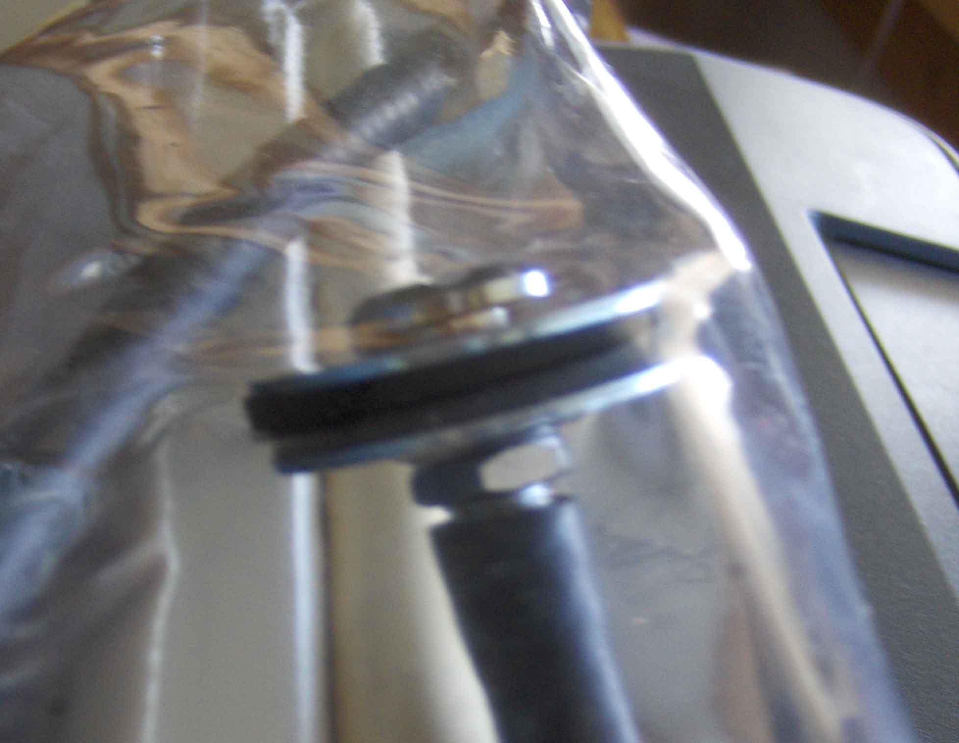

I've been asked a few times how I do the vac forming. Here is the process: pretty simple one too. Harbor freight vac pump. 2/3 of a yard of .015 thick clear vinyl, from JoAnn fabric: (it's about 45 inches long) contact cement a 2 inch strip down each long edge, . . . when you fold it over in the center, . . . the cement makes it turn into about a 24 by 24 bag, . . . plenty big enough for holsters. Bag fitting from http://www.veneersup...m-Assembly.html 2 feet of rubber hose couple pieces of pvc or two slats and a clamp to hold the bag closed Put it all together, . . . have fun. May God bless, Dwight
