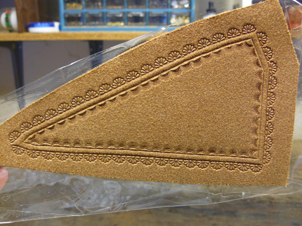

Here's a quick sample I hacked out this morning. It's from a Wickett & Craig double-split, which are cut relatively smooth. When you order a tooling side from them, they split it to any thickness you need, free of charge, and if you request it, they'll also send you the material that was split off the side at no extra charge (although I suspect it may affect your shipping charges slightly). Kate
Yes, either side of any veg-tanned leather is tool-able. It might be useful to tool on a split if you are looking for a rougher texture to put some carving or stamping on. The only thing I've used splits for so far is to make plugs for appliques. Kate

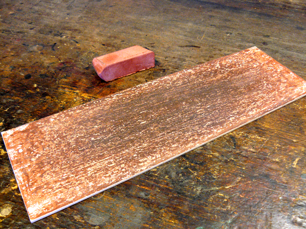

Mine's just a 5"x15" piece of illustration board. I used to use the white stuff all the leather suppliers sell, but then saw some of the red buffing compound at Sears and decided to try it. I like it much better. I inadvertently got some oil onto it when I was re-sharpening one of my blades, and discovered the oil seems to improved the performance of the strop, as well. Kate
