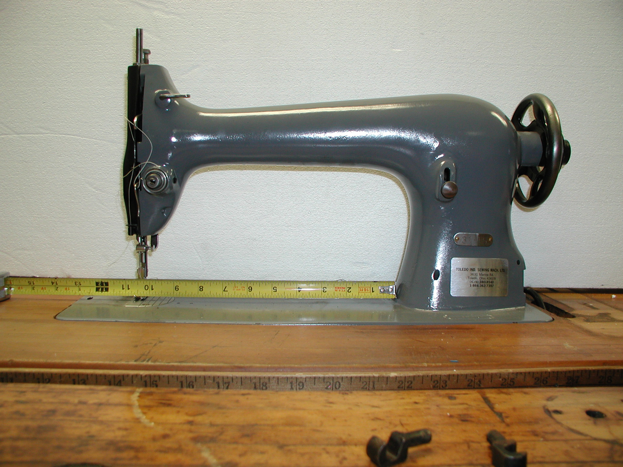

  10. It's a 17" Singer 11 Class,alittle shorter than the one in the pic.
