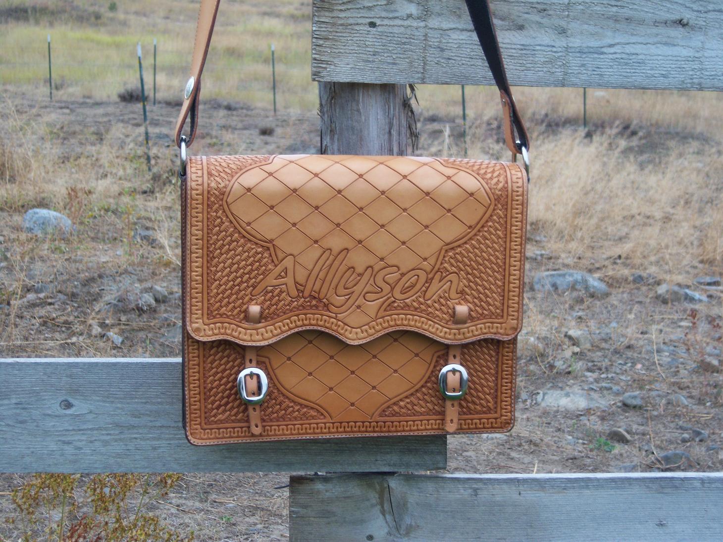

another Laptop case
Tkleather1 replied to Tkleather1's topic in Purses, Wallets, Belts and Miscellaneous Pocket Items
Thanks guys I sure do appreciate all of the kind words. and Tim I got hurt at work about a year ago and am just now starting to get the ball rolling with the state and what not. Thanks again to all. -
Well I havent posted in a while because I finally started down the path of going back to college.(some of you know and others dont but I got hurt at work and blah blah blah). Well I have been busy in the shop and here is the latest. There will be many more pics of other stuff in the next week or so but this is the first one completely done. Laptop case. 7/8 H.O. Tooled using Barry King basket and Tandy meander or Runnin W whatever you want to call it. Finished with light coat of EVOO and topped with two coats of Saddle Lac. Lined with pigskin. Any questions or suggestions let me know. No this case is not padded as per customer request. Thanks for lookin Tim Worley TK-Leather
