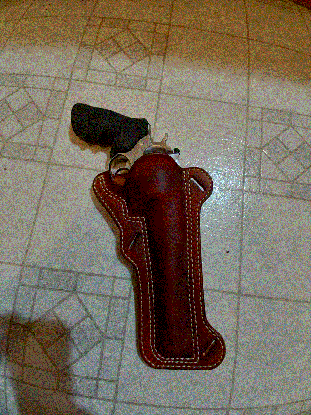

first pancake holster
Thadrick replied to Thadrick's topic in Gun Holsters, Rifle Slings and Knife Sheathes
I plan to put a leash over the hammer. Thanks for the compliment. -
bladegrinder replied to Thadrick's topic in Gun Holsters, Rifle Slings and Knife Sheathes
That looks great, personally I would have had the leather cover the trigger, don’t want anything unintentionally hitting the go switch. -

I have no idea if I did it right but this is my first. It was very easy compared to other holster styles ive tried so has me wondering if I did it right. Took me about 2 hours not including time waiting for dye to dry. Still needs sealed but I need to let it dry a little longer. Let me know if Im doing it wrong please
