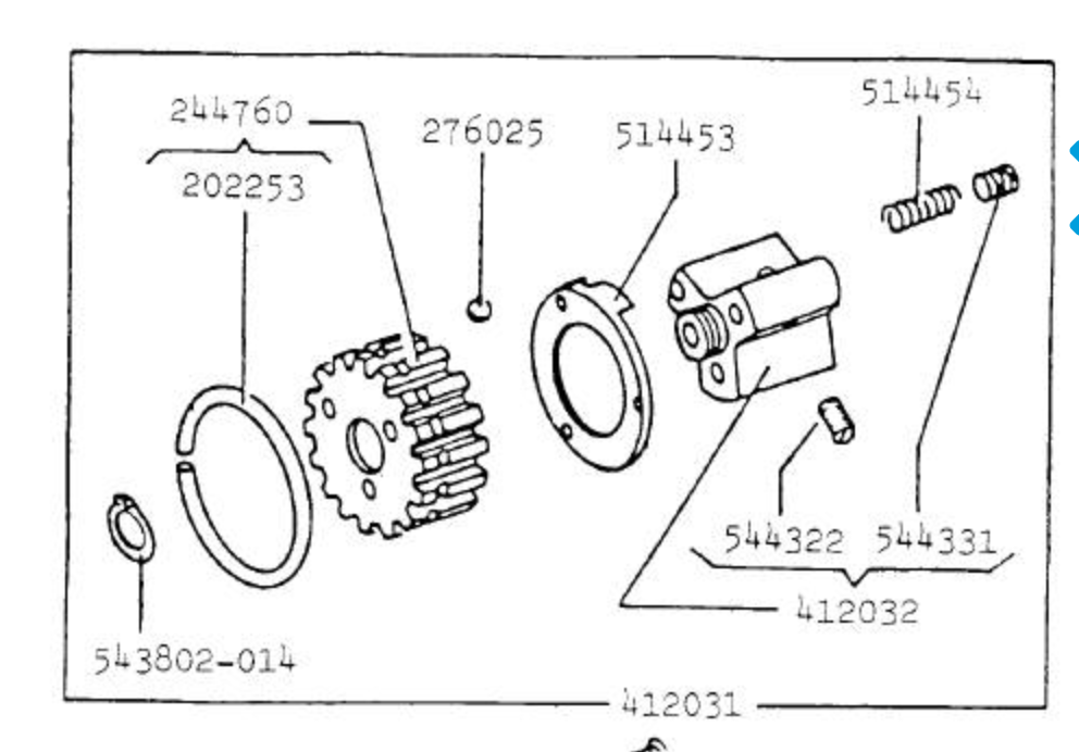

I believe you are on the right course. Here is a parts manual for a similar machine that seems helpful to understand the pieces: https://www.manualslib.com/manual/153942/Singer-211a165aa.html?page=15#manual The following page has descriptions of each part. The way I'm interpreting is that each of those three fat screws on the end has a spring underneath it. Together, those three screws through their respective springs provide pressure to the plate that has a detent for the ball. Someone may have screwed those adjusting screws all the way in, not knowing they were adjustment screws. -

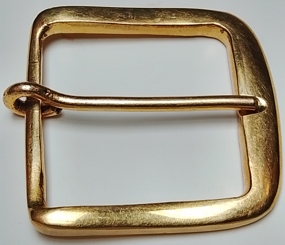

Hi John G Welcome to the forum. To me the most important points are: Strength/solidity Size Design/style Finish to me is part of the style, and I normally prefer just a regular brass finish like the one in your picture, alternatively it could be silver coloured, but I prefer no "bling" on my buckles. Prize is not especially important since I don't make 1000 belts, and compared to the time invested in making a nice belt, the prize for a buckle is only of secondary importance. But I guess that if you run a regular production of belts, it is of more importance. I like the small "dip" wehre the prong of the buckle nests. That is a nice touch in my opinion. Depending on what type of product I am making, I use either "normal buckles" like the one in your picture, or "roller buckles" or "center bar buckles" For belts I prefer sizes 1.25" and 1.5" (30mm and 38-40mm). Brgds Jonas -

Hi everyone, I’m new here and just getting started with a small project I’ve been working on for some time: hand-cast solid brass buckles and hardware. I run a small foundry and workshop near Nairobi, Kenya, where I make each buckle in small batches using traditional sand casting. Right now I’m at the stage of introducing these pieces and learning what makers actually look for in their hardware. Strength and authenticity are my focus, but I’d love to hear what you value most — sizing, finish, style, or price point. Here’s a look at what I’ve made so far: https://origibelts.com/collections/wholesale Any thoughts or feedback would be really appreciated as I start this journey. Thanks for letting me be part of the community. Sincerely, John G. Origibelts – Nairobi, Kenya

I will post a new-and-improved video of the bobbin, but I've been trying to figure out the safety clutch, and there does not seem to be much info on this particular style online, and I don't see it discussed in the manual. The 3 attached pictures show the 2 set screws and an end view. I assume that the 3 screws in the end view determine the force needed to disengage. The only picture of these in the manual (Fig. 65) shows them flush with the end, but on my machine they are turned all the way in. If my assumption is correct, I think I'll experiment with different settings to get a better feel for the disengagement/re-engagement. -
