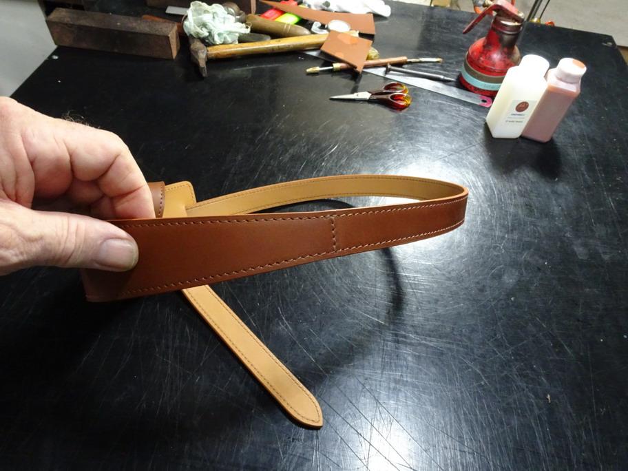

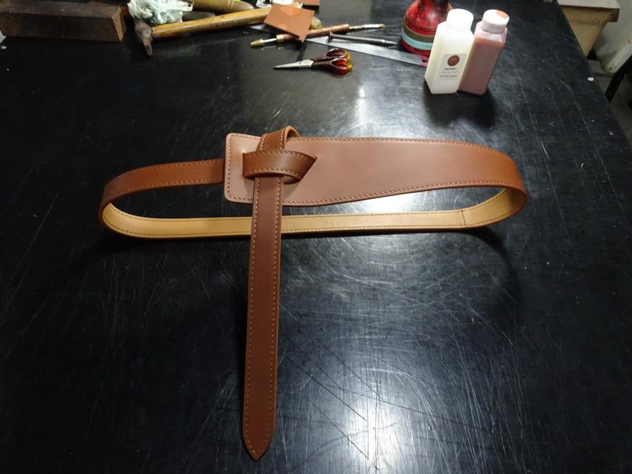

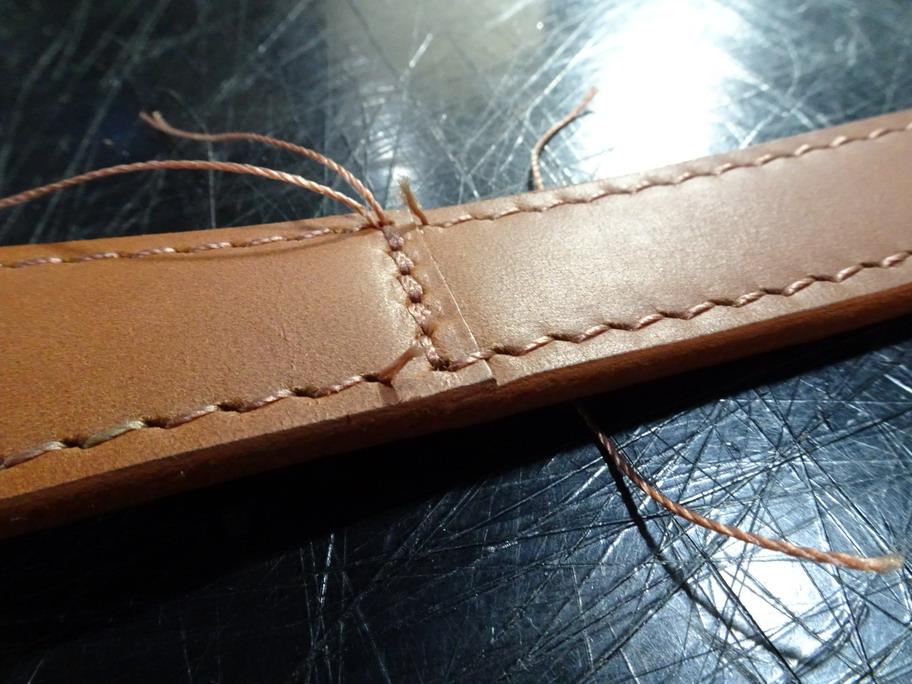

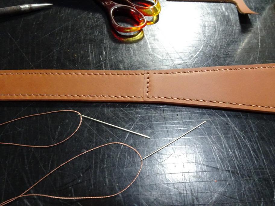

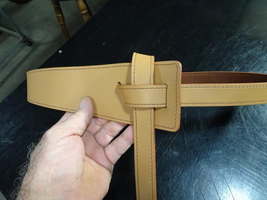

  5. I feel your pain. Interesting design so the belt is now multilingual. kgg

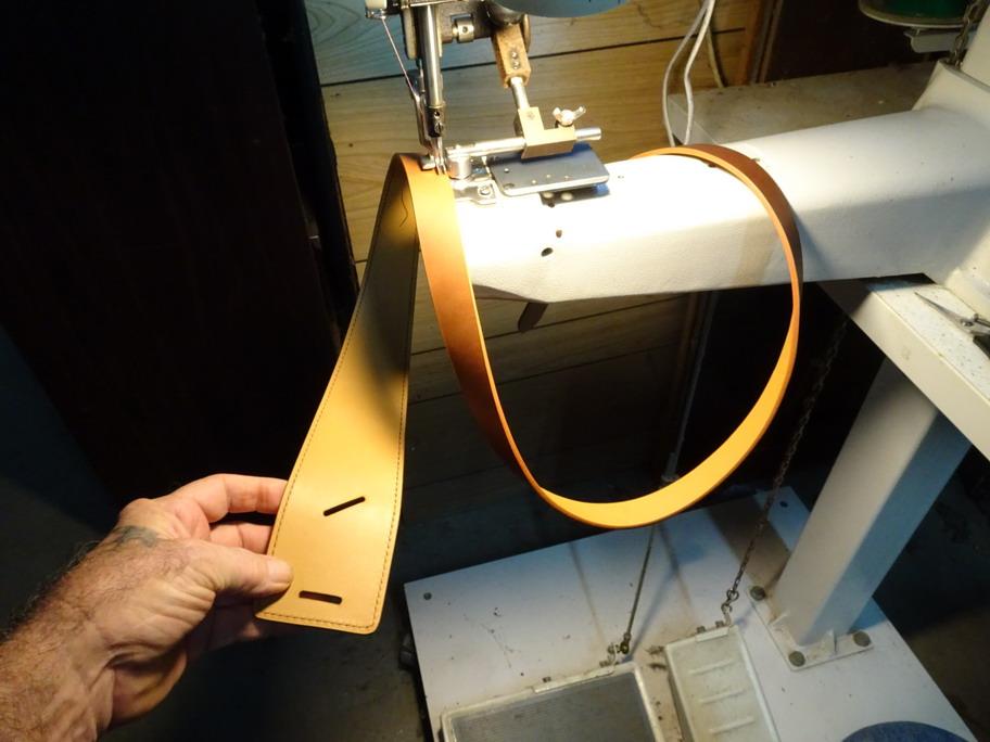

  6. In the past I have sometimes polished the tips of my needles to not be so sharp to help stop them cutting threads so much when back stitching or going over threads already in place. On this particular job I was aiming to make a belt that could be worn both inside and out so I wanted to be sure to have a needle sharp enough to not pucker on the bobbin side. The stitching was done on my Cowboy 4500 with a new 160/23 LR Schmitz needle and 138 poly bonded thread. The stitching went very well all the way from the start up to the last four stitches. This resulted in 3 different threads being cut right through as shown in the pics below. My Cowboy machine knows a few new #%^& words now and like my machine I just never stop learning. I started the stitching at the top of this join went around until I got to the bottom to over stitch and the swearing began. Double needles needed to fix came out alright in the end.
  7. Yesterday

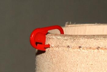

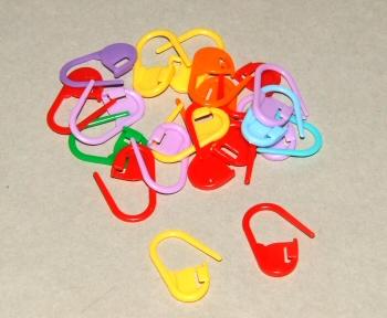

  8. I was getting some things on TEMU and had to bring my order over the minimum value amount. Looking around for something cheap and possibly useful I came across these; they are stitch markers for knitters. I got 80 for about 50p (40c ?) They will keep two pieces of leather in alignment for sewing up

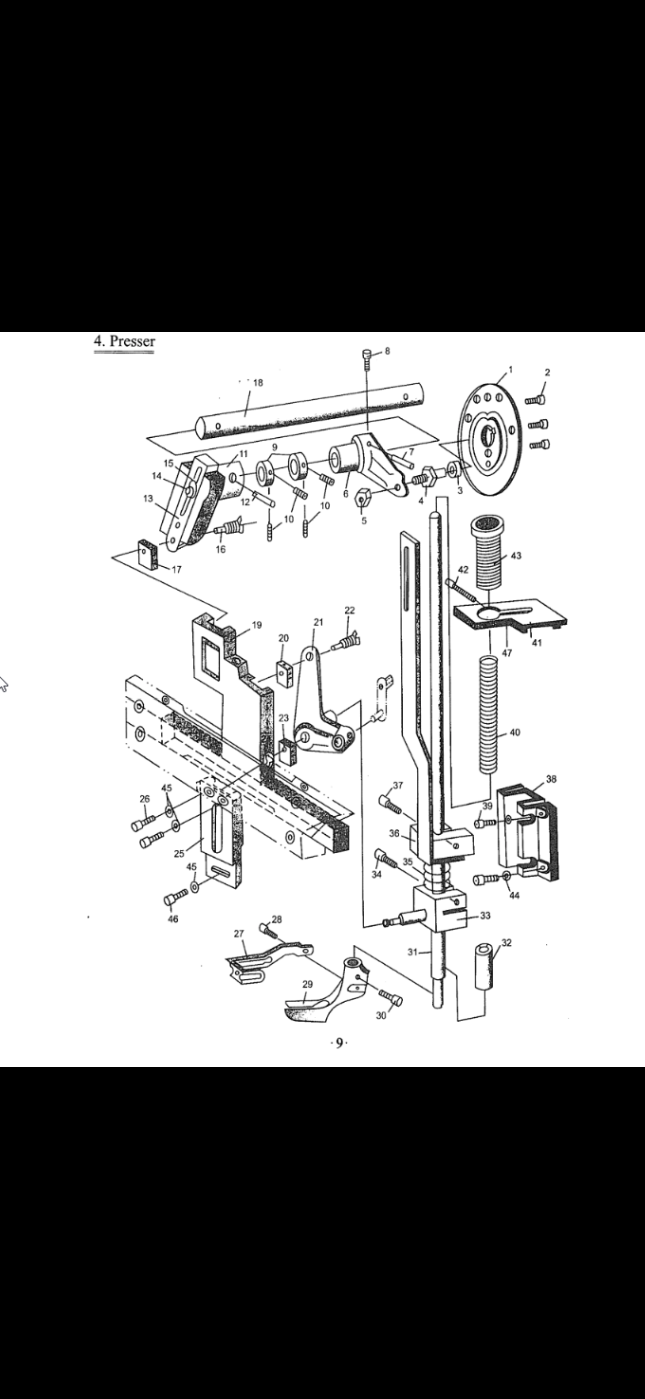

  11. Backstory I had an issue where the presser foot was Stuck in the upright position. I messed with 33 and 36 settings as those were something I found online to adjust. In the end the issue was that 14, a bolt that controls the step height, had come loose and went to a 0 height position. I wasn’t sure which direction to offset it. I tinkered and got the machine running again. Current The machine works but it seems to struggle more than before when getting started. I don’t have the same low speed control I once did. I’m also having the presser foot lift getting stuck after raising the presser foot. The problem gets worse the higher I need to lift it. I can only unstick it by rotating the machine. Obviously not ideal for stitch placement! Also makes it unusable for thick stuff which is what this machine is for. Here is where I need help… What should the factory position of bolt 14 be on the slider? What is the best way to adjust 33 and 36 back to ideal settings? Are there any additional things I should be checking? If you can point me to the information or a idea I would greatly appreciate it. I’m reasonably handy but don’t have any specs for this stuff. Thanks, Tom

  15. It's based off of a Seiko CH-8B which are easier to find parts for. They started with those machines and modified the foot lift walking mechanism. I'd download a manual for the Seiko and work off of it. Anything in the Seiko manual that doesn't match your machine was custom made by Ferdinand and I'm not aware of anyone who is making those parts (unless someone has old stock).

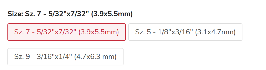

  16. just measure your current punch with calipers to get the dimensions. Or ask your die maker if they have made anything similar. They may already have something they have created for someone else.

  20. @BlackDragon, I didn't realize you could ask for that! Thanks.
  21. I have had a Cowboy cb4500 since 2012. I bought it from Toledo Industrial Sewing Machines. One of my best friends bought a Cobra Class 4 in 2011. They have the same capabilities and capacities. We both use these machines multiple times every week; sometimes on a daily basis. As long as you keep them oiled, including opening the left faceplate cover to get to the internal crank shafts, they should keep sewing for decades. Note, that there are many accessories available for both of these heavy stitchers. Most are available from the primary dealers. Others are made by custom shops, like extra narrow feed dogs and throat plates, which allow you to sew narrow straps or thinner work than the original equipment was built for. My buddy and I both have narrow feeders and throat plates and leave them in most of the time. I only restore the originals if I am going to sew something with #346 thread and a #26 needle.
  22. If you have a Tandy store nearby, take your punch or belt there and compare the sizes. They have 3 sizes. Maybe these listed sizes might help you.
  23. I have been making belts for years using an oval punch to put the small holes opposite the buckle end of the belt. I am looking to have a die built to click them out. The punch I am using is a very old one that does not have the size on it, so I am not sure what size to tell a die maker to use. I make 8 oz to 16 oz belts so the oval holes sort of works well for that range. Since I am not sure what size to advise the die maker, I thought I would ask to see what size other folks that build belts use? Any help would be appreciated. Thanks

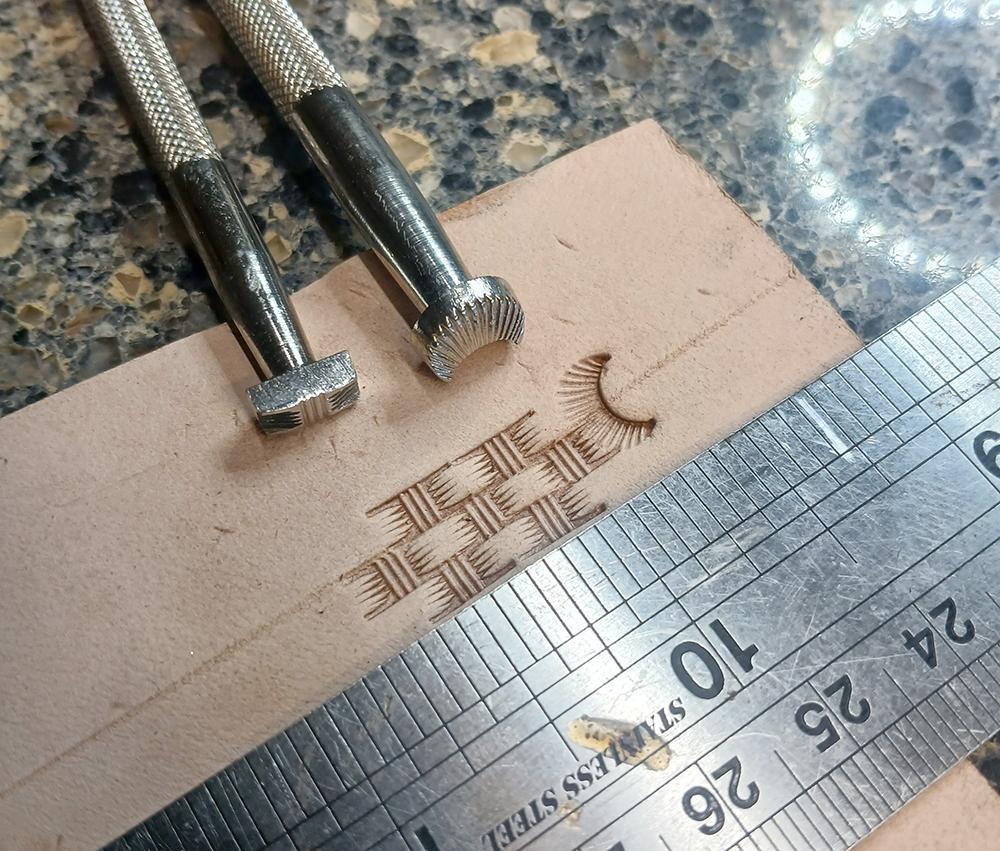

  27. I found a couple on Bruce Johnson's site but the bar looks to be different. Some stamps can be impossible to find because they may be custom made. Trying to copy something so exactly can drive you nuts, trust me I know. People wont notice most of the tiny differences so if you find something pretty close you'll be fine. https://brucejohnsonleather.com/products/stamping-and-carving-tools/basket-stamps
