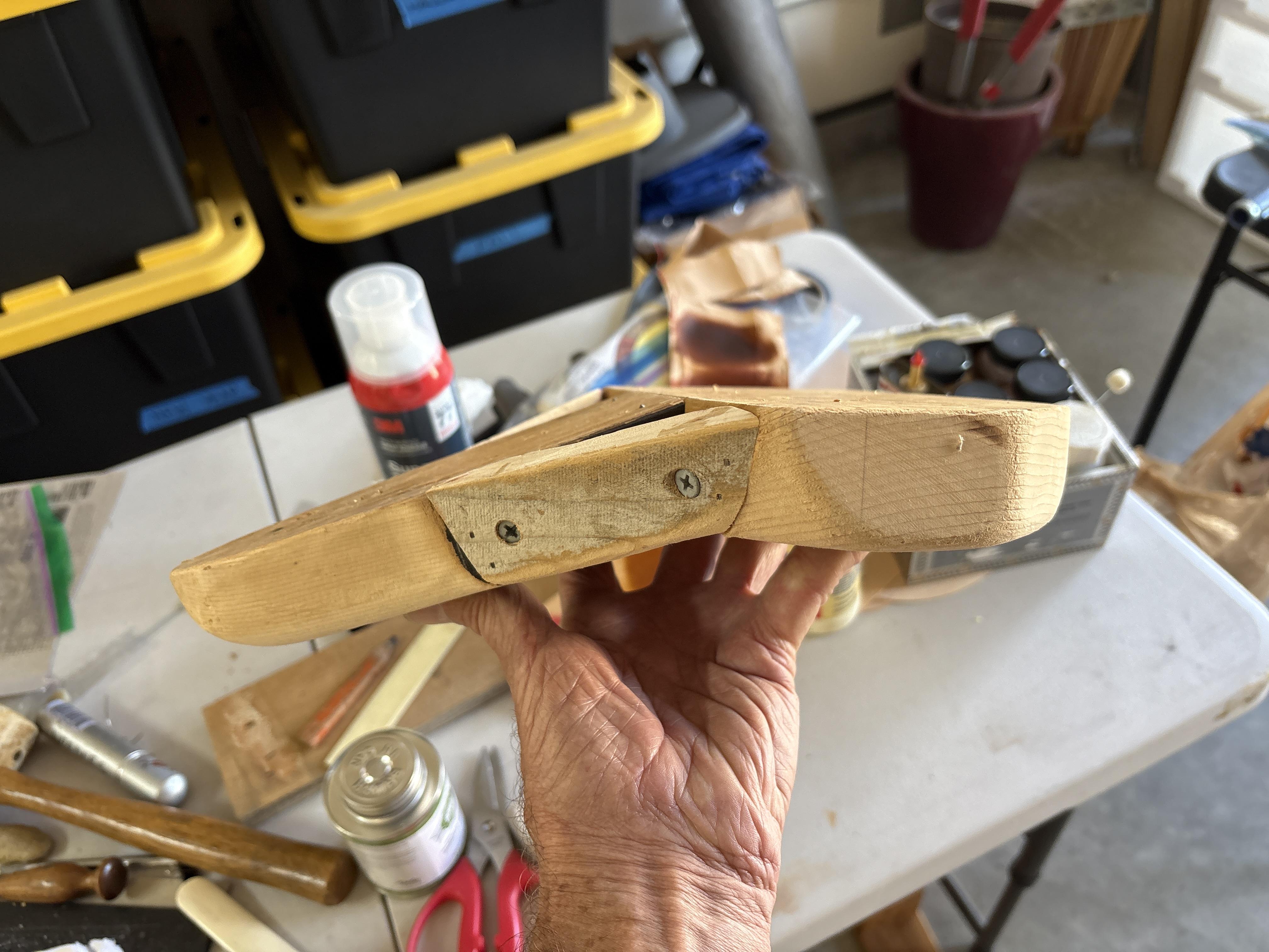

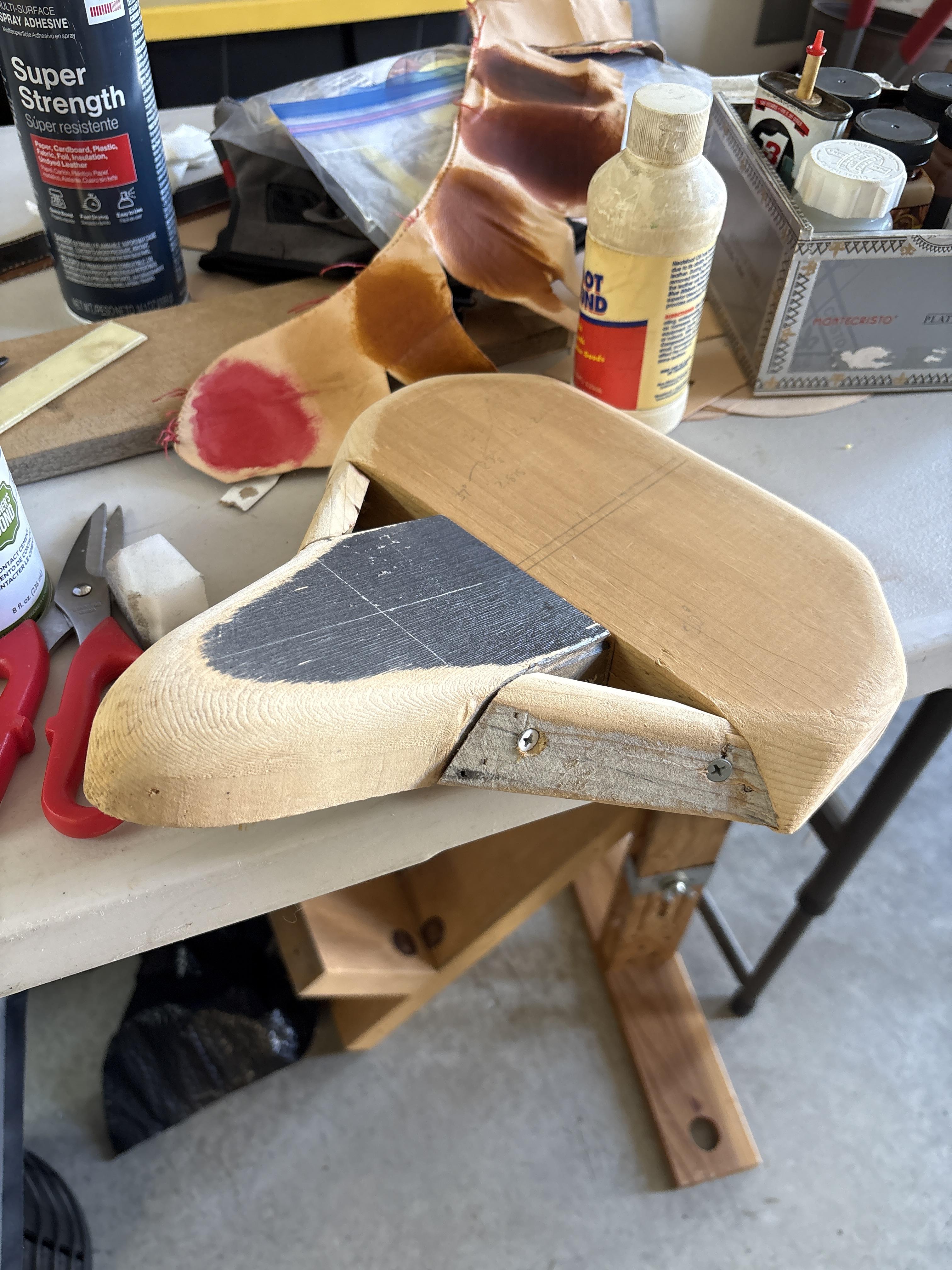

  2. The leather is Tandy’s 2-3 oz. as that is what I had on hand. Herman Oak is sending some 1-2 oz. which will go on the next saddle cover. It is comfy for a beach cruiser, its primary purpose. Attached is pics of the wood form I made and used for initial wet forming. I did use staples to aid that process. Thanks for the comments!
