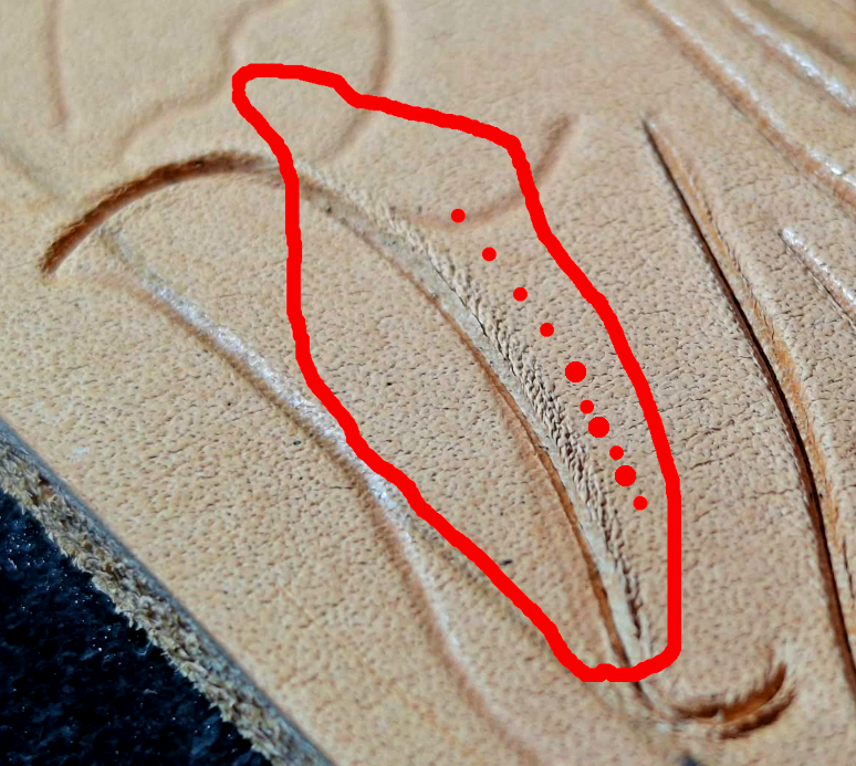

I'm embarassed to ask this when I have experiented with tooling this long already. Seems fundamental or elementary. I put red dots near what I mean. The slightly raised ridge lines with tiny stretch marks pulled along with them. It's good leather; HO. I did have to stick it in the fridge overnight after tracing lines, to work more later on when I had more time, but that's going to happen a lot in my life. If I'm moistening it too much, esp. to bag and refridgerate, I'll have to get a handle on it. t's more moist than the color looks here; a whack on a shader burnishes nicely. If it's because my blade isn't sharp enough... I don't know what to do. I have worked at that art of sparpening until it will shave some skin off my thumb. Surely that's at least as sharp as some guys who do great and claim personal sharpening deficienies. It is stroped to mirror smooth and all. I didn't start or end those visible lines very gracefully but, neverminding that -- ...could I be cutting just too deeply? It's 9 or 10 oz. and it just didn't feel like I was cutting through too deeply relative to the leather's thickness. But I guess going deep enough may force the line so wide, with a standard blade, that it eventually reaches the end of the bevel on the blade, even. Maybe that could cause pulling as well. I'm a little lost on something here that's obviously such a beginner thing I should never have gone this long without asking. Sometimes I luck up and only have this happen on one side of lines that I'm going to bevel enough to cover it up. Back beveling doesn't help as much, lol. Thanks for your thoughts. Too moist and too deep?
