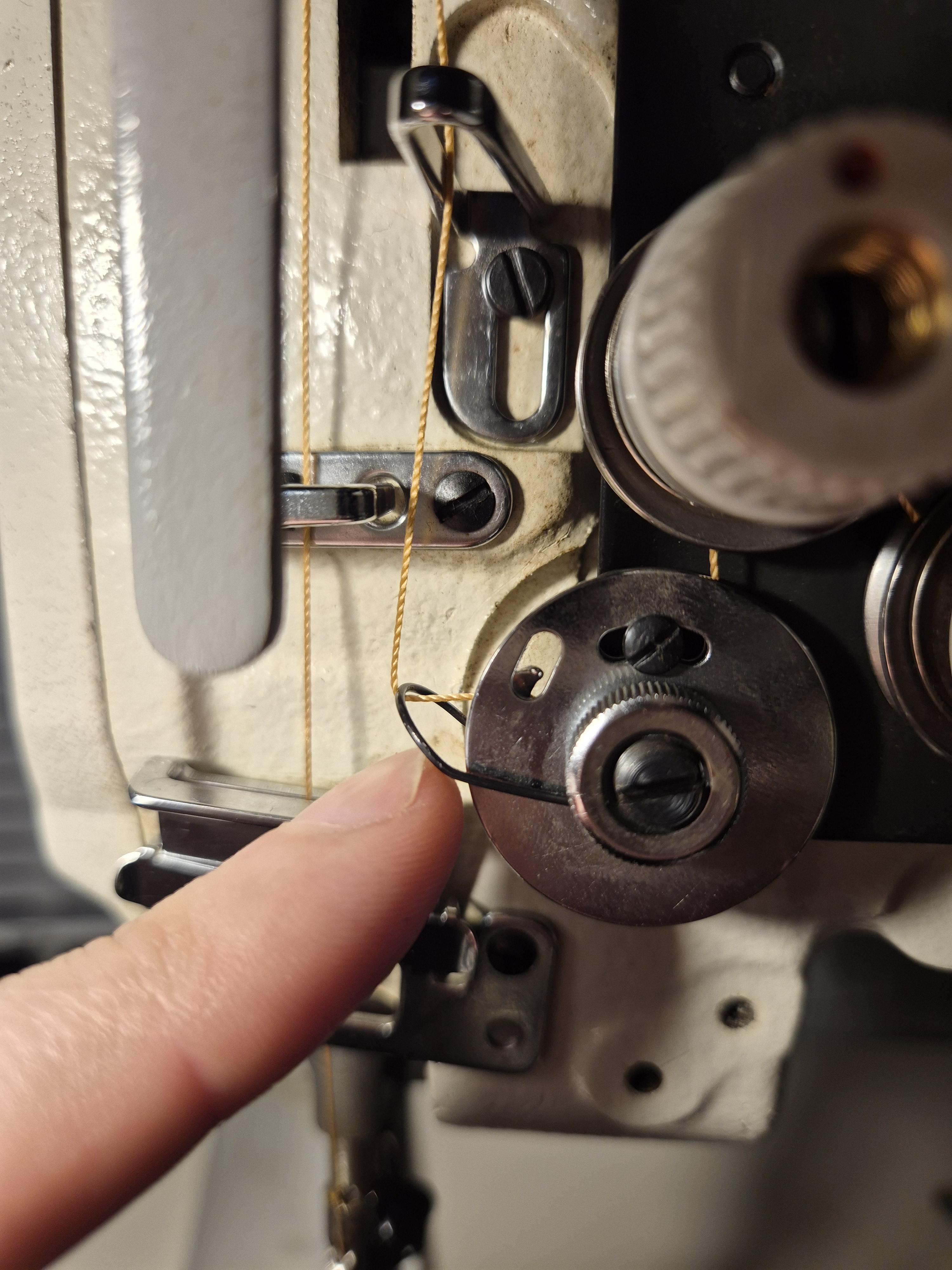

  2. I was trying to figure out what might have caused the issue initially and it became clear very quickly when rethreading! So the little black guide photographed doesnt click as I am led to believe it should? So the thread gets wrapped around the disc after a couple of revolutions and the thread tension is far too high. Ive asked a lot from you already but do you have any further advice regarding this matter? Thank you all again, Merrick Sorry, photo attached here

  4. Awesome! šŸ’ƒ Make sure the handwheel turns freely (easiest to check with motor drive belt disconnected), and that it forms stitches. If all checks out you can reconnect the drive belt and go back to stitching under power. The safety clutch may disengage again if too much load is placed on the hook driving shaft. Two things that will make it go much better for you: Start each seam with the take up lever at its highest position Hold the top thread for the first couple of stitches

  10. Well Ill be damned, less than 24 hours and you have helped me troubleshooting an issue ive had for over a year. The drive shaft is now turning. Ill keep you updated on any issues that may follow... do I use it manually to ensure that all blockages are removed for the time being?

  14. Hi Wizcrafts, I remember reading a lot of your posts when choosing this machine in the first place, you were very informative. Please find attached a photo (hopefully) and see if this would make sense regarding those diagnoses. The area circled in red (I believe is the hook drive shaft) is not turning with the areas circled in green. Thank you very much, Merrick
  15. Either the safety clutch has tripped due to a thread jam (most likely), or the driving gears have loosened on the drive shafts.
  16. Ah okay, ill try to find a suitable file format. Thank you for letting me know. Basically, the handwheeel turns but the drive shaft for the hook is not turning with the rest of the mechanism when viewed from the underside of the machine. Everything else seems in order! Cheers, Merrick

  21. Thank you so much for your guidance.. I have tried to reengage the safety clutch but nothing is happening to the button as I push the hand wheel back, I can feel a very small amount of feedback but nothing past that, it certainly isn't dropping down as I believe it should? This is my first industrial machine (actually my first machine altogether), it might take me a bit of time to troubleshoot, please bear with me! Thank you very much again for your help so far. 20260120_182522.mp4 20260120_182905.mp4

  24. Thank you so much for your guidance.. I have tried to reengage the safety clutch but nothing is happening to the button as I push the hand wheel back, I can feel a very small amount of feedback but nothing past that, it certainly isn't dropping down as I believe it should? This is my first industrial machine (actually my first machine altogether), it might take me a bit of time to troubleshoot, please bear with me! Thank you very much again for your help so far.
