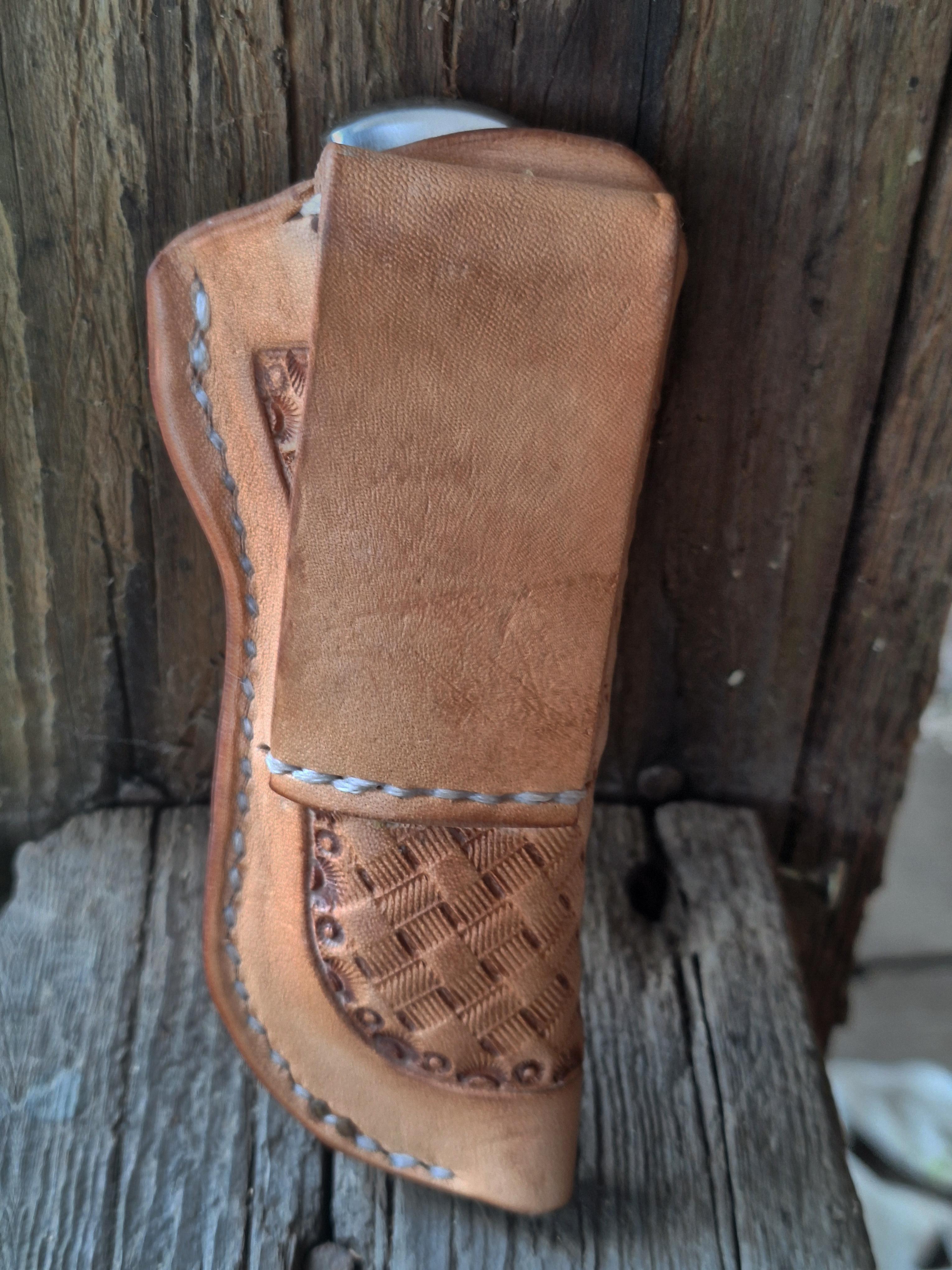

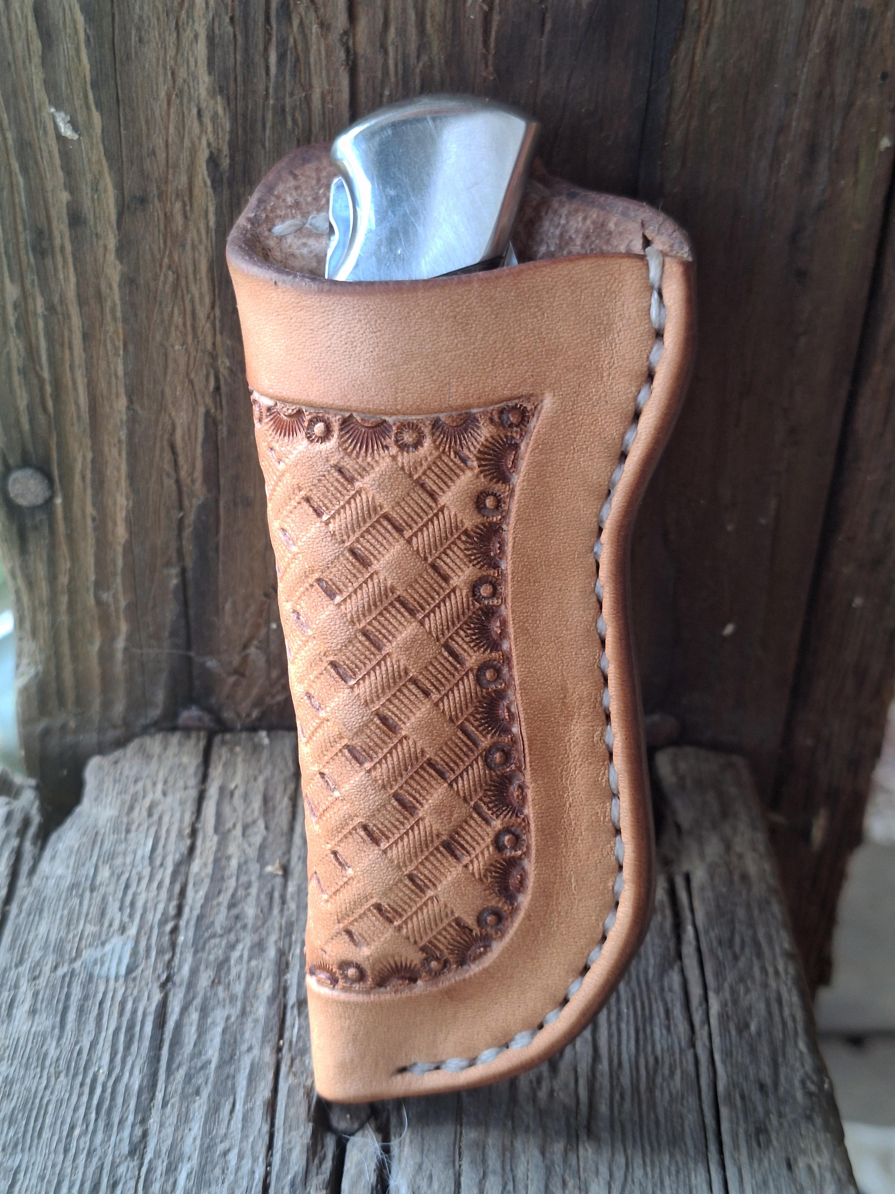

  6. Designed this to fit a Buck 112 size knife, it was a fun project.

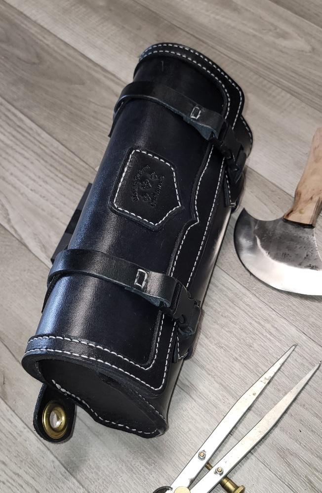

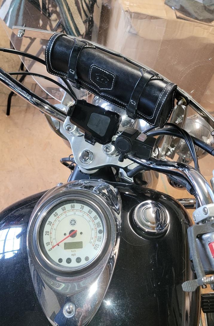

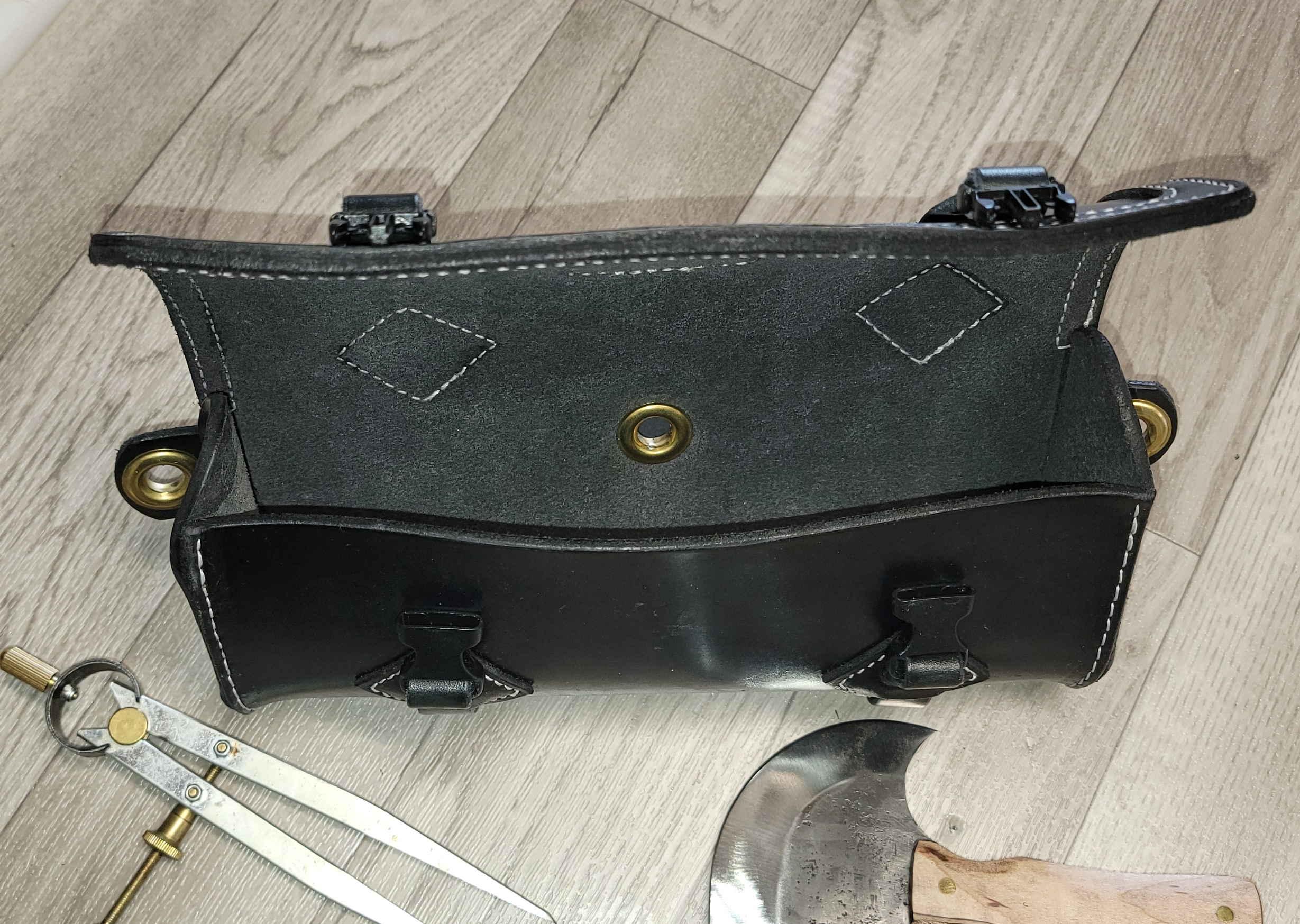

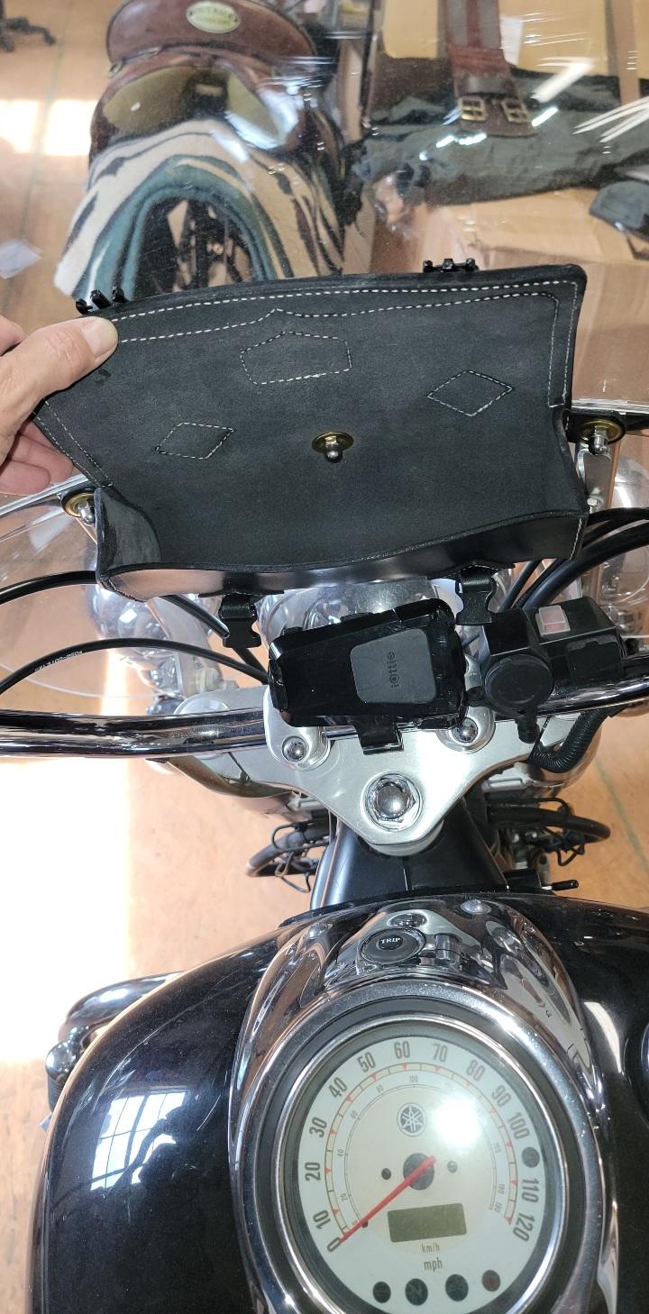

  9. I put together a fork bag for my bike. I guess it's actually more of a windshield bag. I used 10oz vegtan dyed with vinegaroon and used resolene to seal. The bag is 10.5"x 5"x 2.5" (mount point is 13"x 1.5")

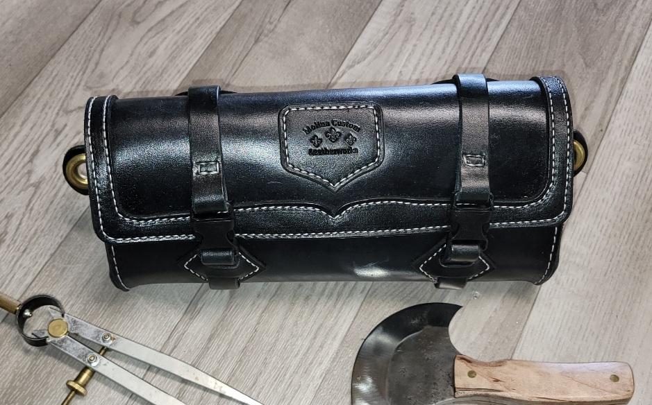

  16. Part of the problem is that you have also burnished it by rubbing on it. My only suggestion is to make a few more around on the wall and make it look intentional, it will add some texture and difference to the background.

  21. It took me a while to spot it too. Only a leather worker would pick it up, but I 'd think the average person wouldn't see it. But as suggested, antiquing might do the trick . HS Nice work BTW
