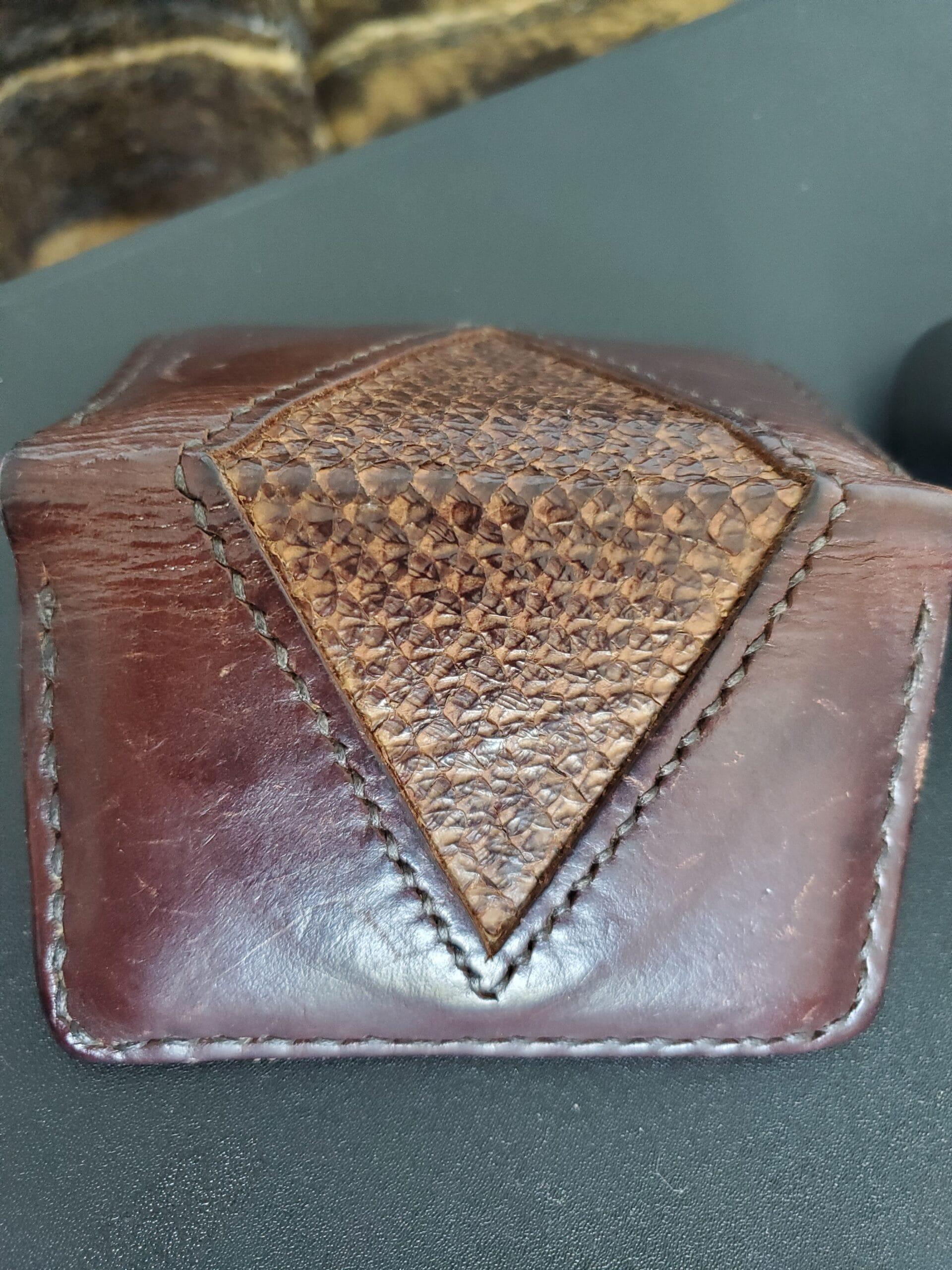

@bvdv @kgg I don't make anything from them yet, but I am planning to start this winter. I have some locals who have seen the leathers and have asked if I can make wallets and rifle slings. Here is a wallet a guy I know made with some of the leather, wallets about 4 years old here:

Very interesting. What products have you made with the skins? kgg
