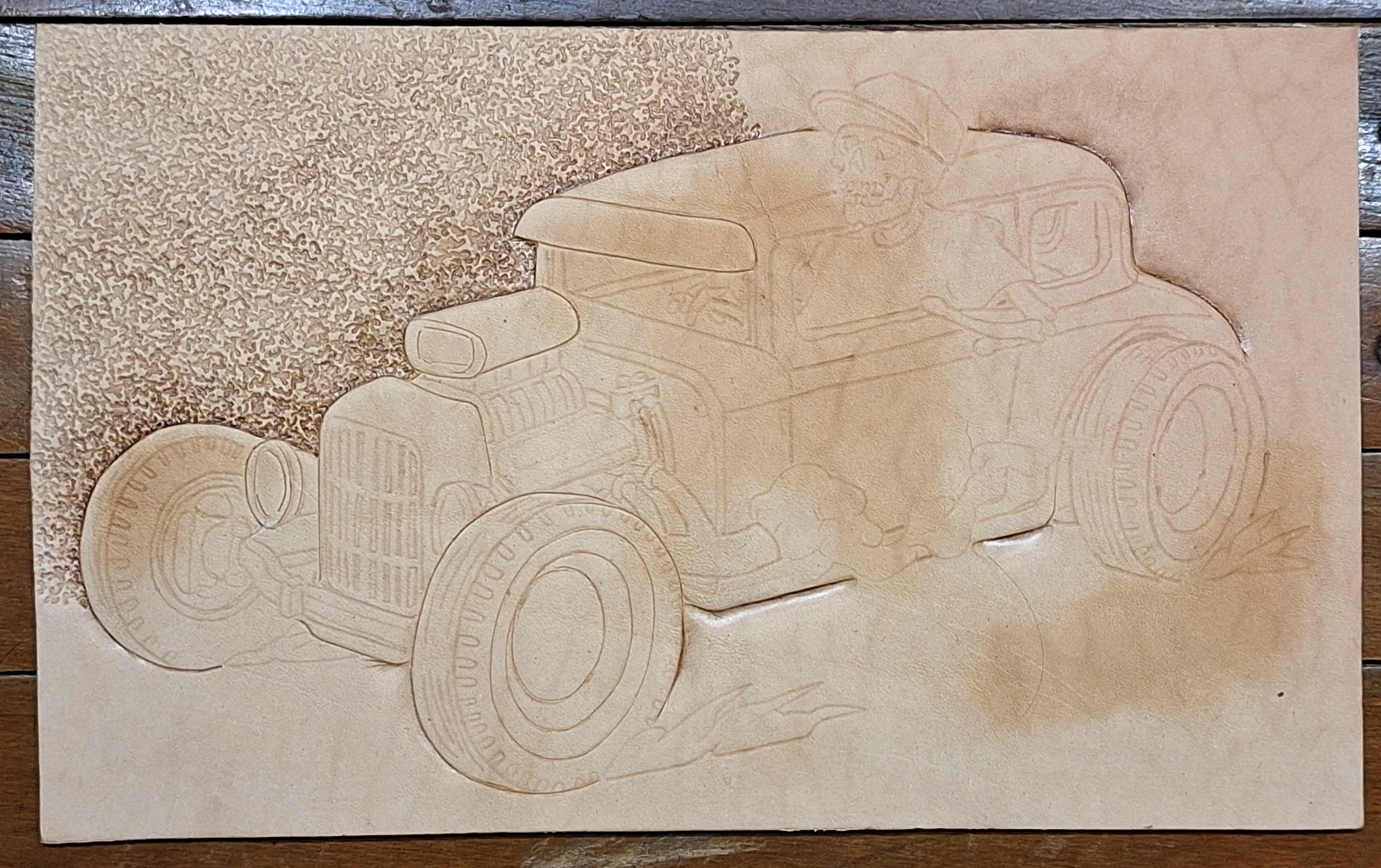

Trying out some new leather from Traditions Leathercraft on a larger piece 10 x 6 inch. The leather has a feel that took a little to understand, after it is very nice to work with providing a nice dark burnish. Trying out different aspects bevellling, backgrounding, matting, and cutting. Thus skipped around on the tooling.

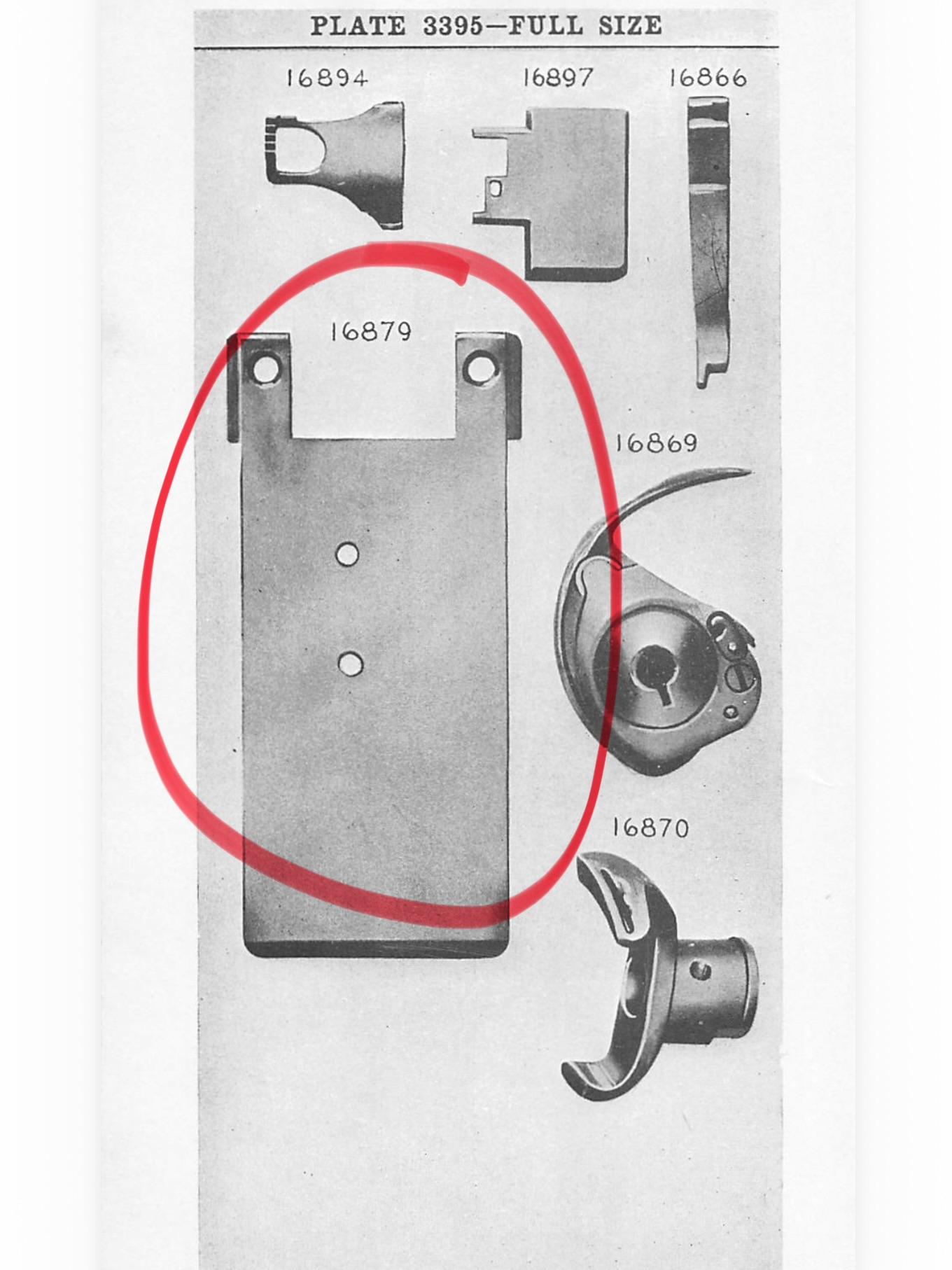

I recently acquired a Singer 17-30. It has a feed dog but no needle plate nor needle/throat plate holder. I found the needle plate I need and ordered it. I can’t seem to find the throat plate holder, Singer part #16879. Does anyone have an idea where I might find one or an equivalent to fill the role? Thanks.

Of course. For Singer machines that is a viable option, provided you can find the part number. I have a few screws I need to find the part numbers for so I can order them that way. But when I get off the beaten path: Manufacturer went out of business Manufacturer considers my machine obsolete Manufacturer has no dealers from which I can easily and affordable purchase parts Brand name on the machine is not the actual manufacturer Parts list for machine has no photos so you don't know which set screw it's referring to The ease of a midnight transaction on Ebay calls my name then I want to measure the screw and order it by its dimensions. Given that some of these sizes are uncommon outside of Sewing Machine Land, someday I aspire to look up which singer parts are the same thread pitch, major diameter, length, and head style and then order by part number through a singer parts dealer even though the screws are going into some other brand of machine. But that requires a lookup table and the only one I've seen is a good start but lacks screw length and head type: https://www.singersewinginfo.co.uk/screw_threads/ But for today I want to be able to accurately measure screws and at least know what size to ask for at the common internet retailers.

Very nice been meaning to do one for my ride, absolutely love the little skull piece
