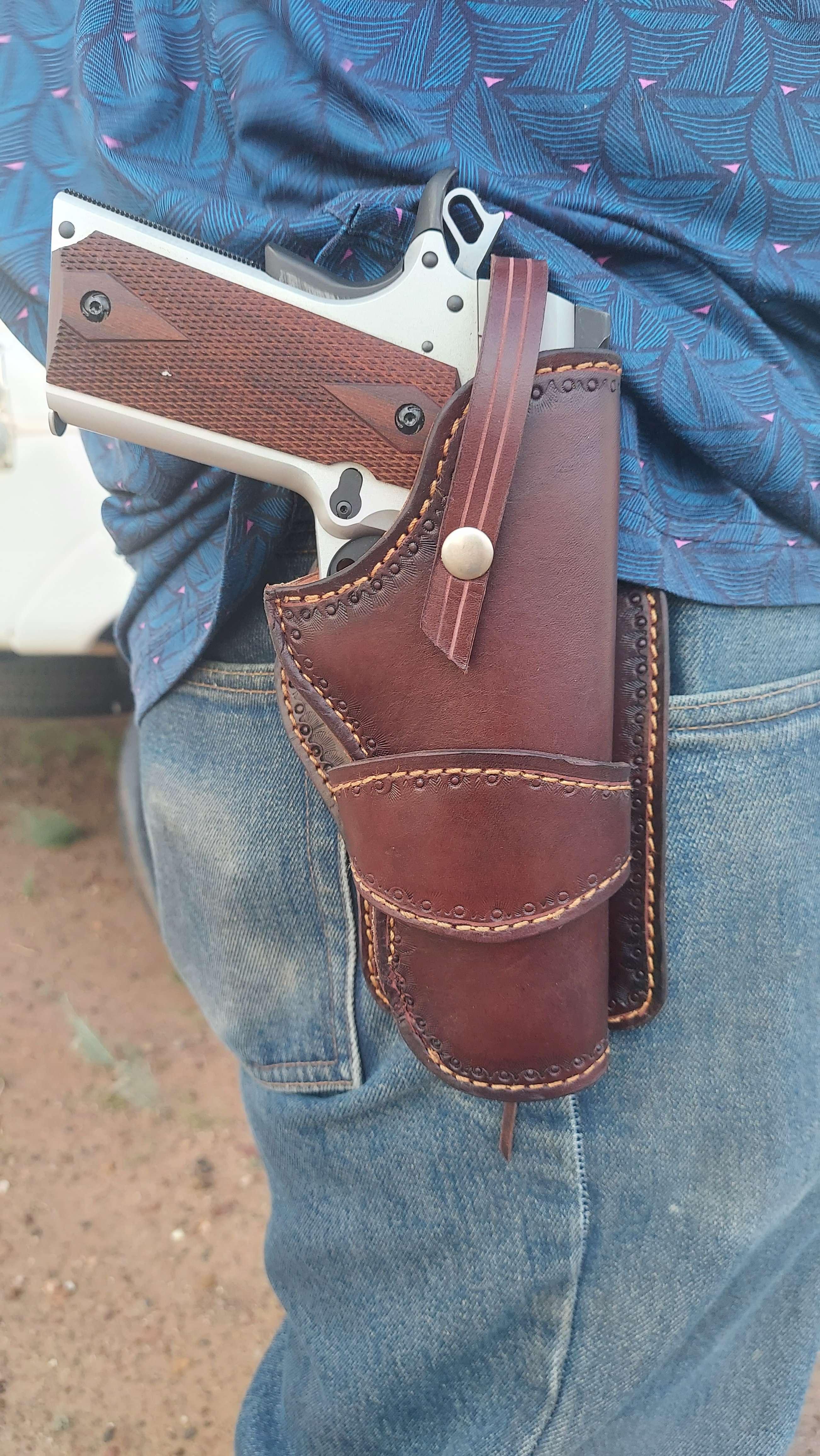

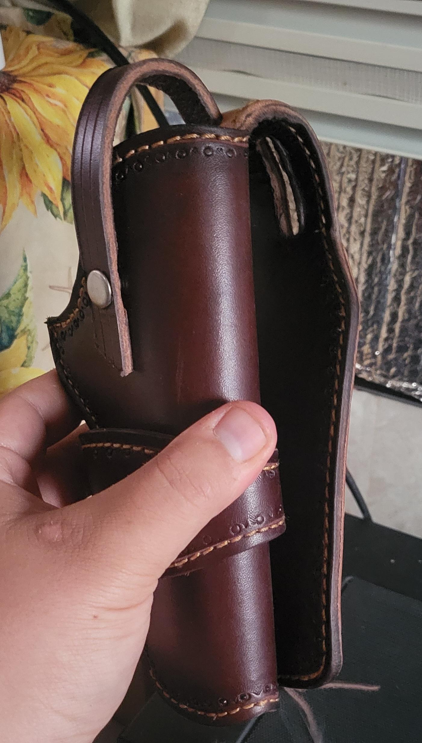

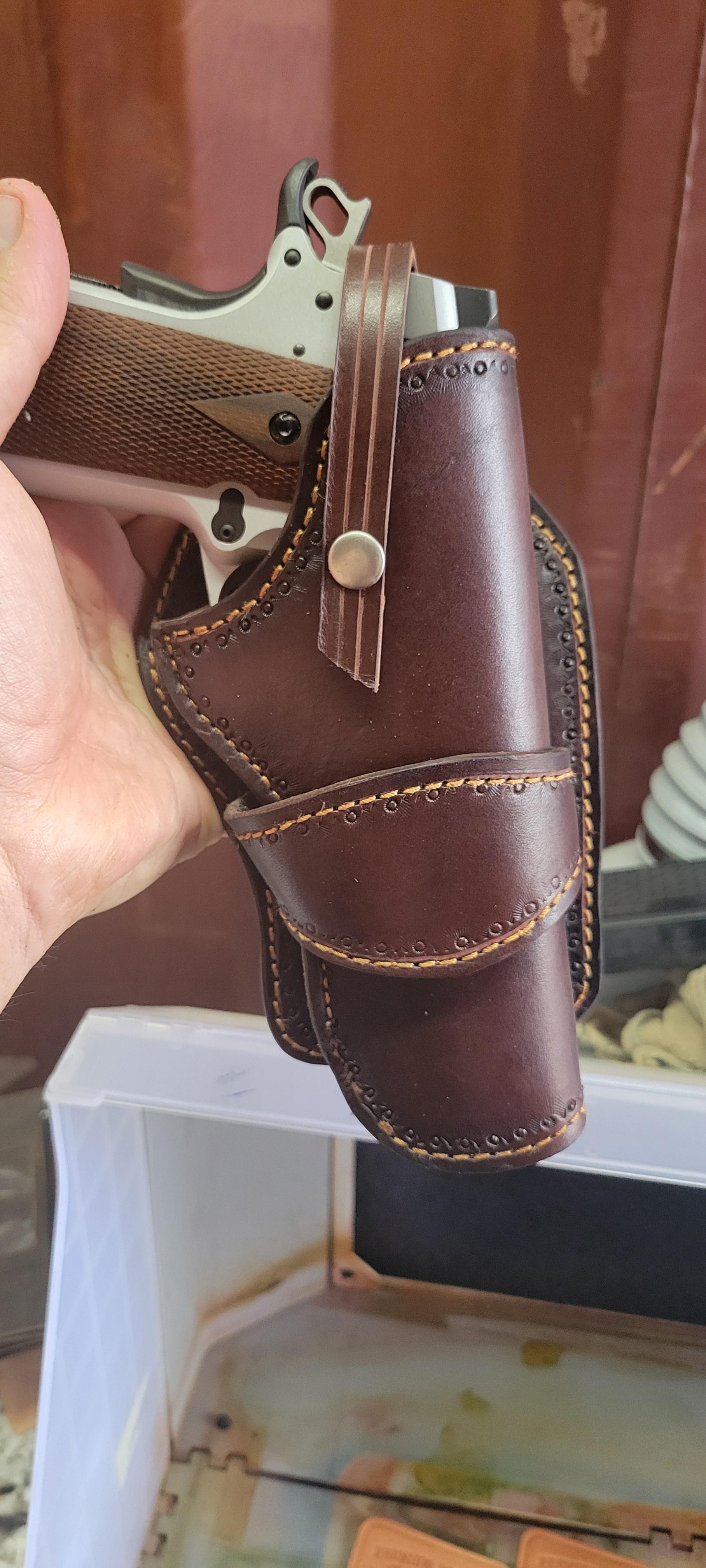

While working a commission for a company, one of the employees asked if I could do holsters. I had never made one so I did my best to find out if I could. I see many mistakes in my part, especially messing up the last bit of stitching of the entire piece. But for a first try im pretty pleased with myself. I'll have to use it for awhile before I'd be comfortable trusting one I made enough to sell though.
