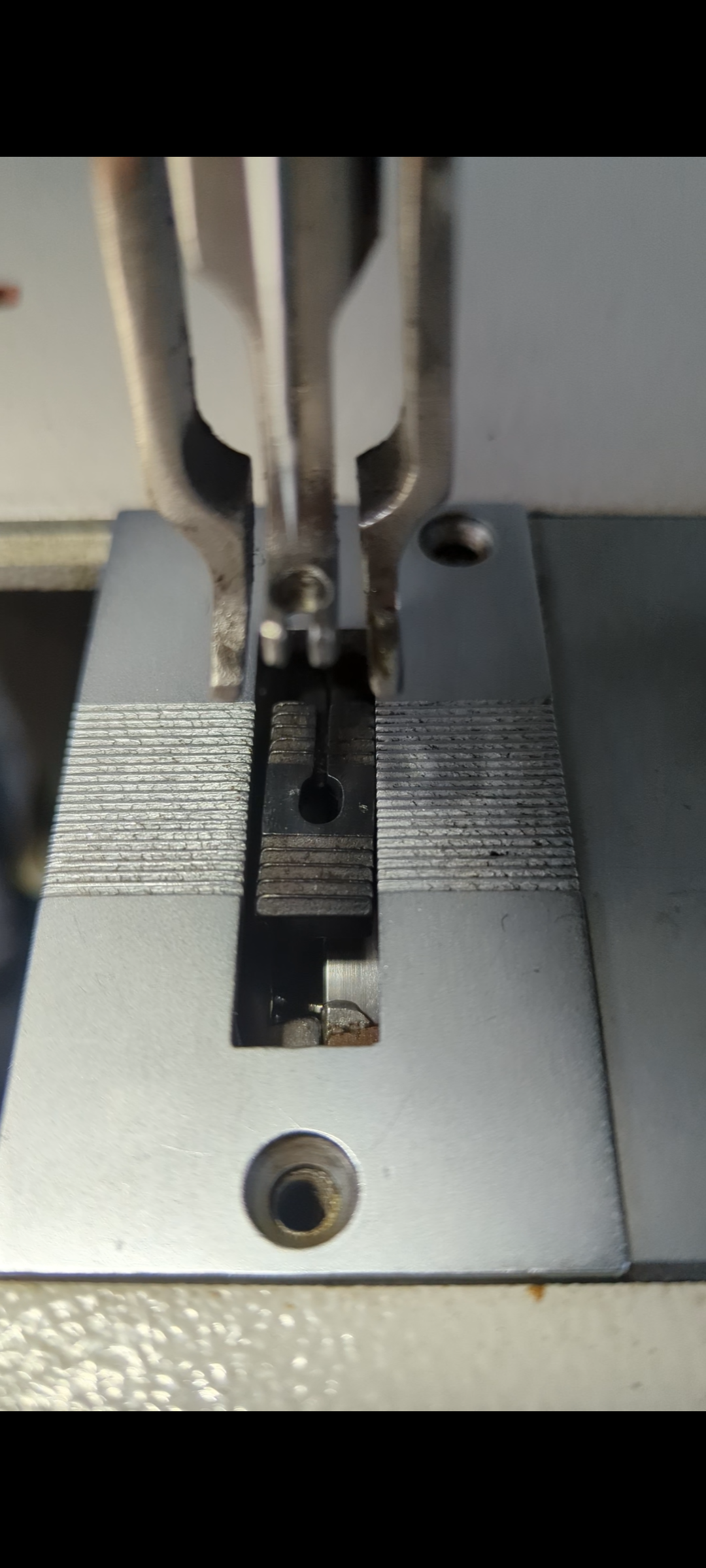

Actually I just noticed feed dog seems to be bent on that pic... Maybe it is and I should buy a new one before trying any other ajustement !
@friquant thank you so much ! @AlZilla true, I confirm and cheked. I added a picture with needle plate in position showing that issue clearly comes from feed dog placement
Thanks, I guess I'll have to give it a try.

There shouldn't be any lateral adjustment on the feed dog because it would then rub/hit the needle plate. The needle should be centered in the foot and needle plate.
Here a link to a manual for a Juki 243: https://www.manualslib.com/manual/1638502/Juki-Tnu-243.html Section 21 (pages 10 and 11) discusses adjusting the feed dog to needle relationship.
On my machine (Pfaff) you set the needle into the centre of needle hole in the feed dog by moving the needle bar frame. This is the upper assembly that includes needle bar and upper feed mechanism. By my machines is always annoying to get some movements. How is this solved by Juki I rerally don't know. check on which axe the needle bar is hanging, is there and screw that you can loose, and than by rocking the wheel you push the whole assembly slightly to the left.
