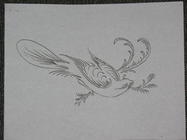

Schno How about something like this... I got this one from a Chan Geer swivel knife class It's pretty simple just trace it out on some damp leather and cut cut cut! Happy tooling Tim scan 091309.bmp scan 091309.bmp
I just reset my scanner settings from 200 to 75 , let me give this a try scan 091309.bmp scan 091309.bmp

Denise or Johanna, I have a problem uploading scanned items. The last one I tried to up load was a black and white drawing of a bird for swivel knife practice. I tried several times and I was unable to upload. I keep getting ERROR file was to big to upload I took a picture of it and was able to upload it. Any suggestions??? Am I able to turn down the scanner? Tim
Cowboy See if these came thru Tim
