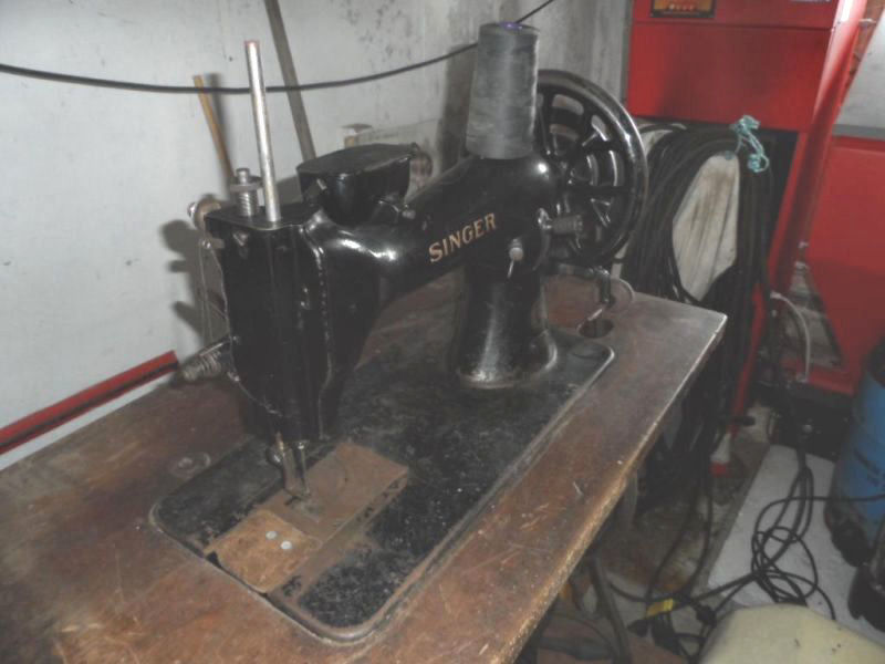

My (First) Sewing Machine Is Here..29K33....its Heavy ;)
Constabulary replied to alexitbe's topic in Leather Sewing Machines
For sewing you just need the one on the topside. The 2nd tension (the one that is missing) is meant for darning - there is an optional darning device for the 29K and thats what the 2nd tension thing is for. The only person I know who has this device is the LW member WIZCRAFT. I personally have never touched one. But I use this tension unit as a thread guide when I wind the bobbin. The needle is catching the inside of the bobbin housing? I´m not sure what you mean - if you don´t mind post a picture of this "situation". When you loosen the upper screw of the needle holder you can shift the holder a bit sideways. Or you probably have to time the machine. If you need a manual you can download one here (direct download link) BUT it is for the later models with removable gearbox and so forth but I think you will notice the differences. The general information are pretty much the same... -
College Sewing in the UK is a good source for 29K parts https://www.college-sewing.co.uk/catalog/search.aspx?keywords=29K but I´m not sure which will fit for th 29K33 as this is one of the older models so I´d download the parts list for your machine and compare the parts numbers https://www.college-sewing.co.uk/SINGER-29K30-29K33-PARTS-BOOK -
WOW - thats really a nice finish! So really he careful with the "Waschverdünnung" stuff! The upper hole is for a tension assembly (including a stud, 2 tension discs, a spring and a nut), the lower hole is a for a set screw that fixes the position of the 360° mechanism when sewing in a certain direction. It prevents the mechanism from moving out of the sewing line. -
