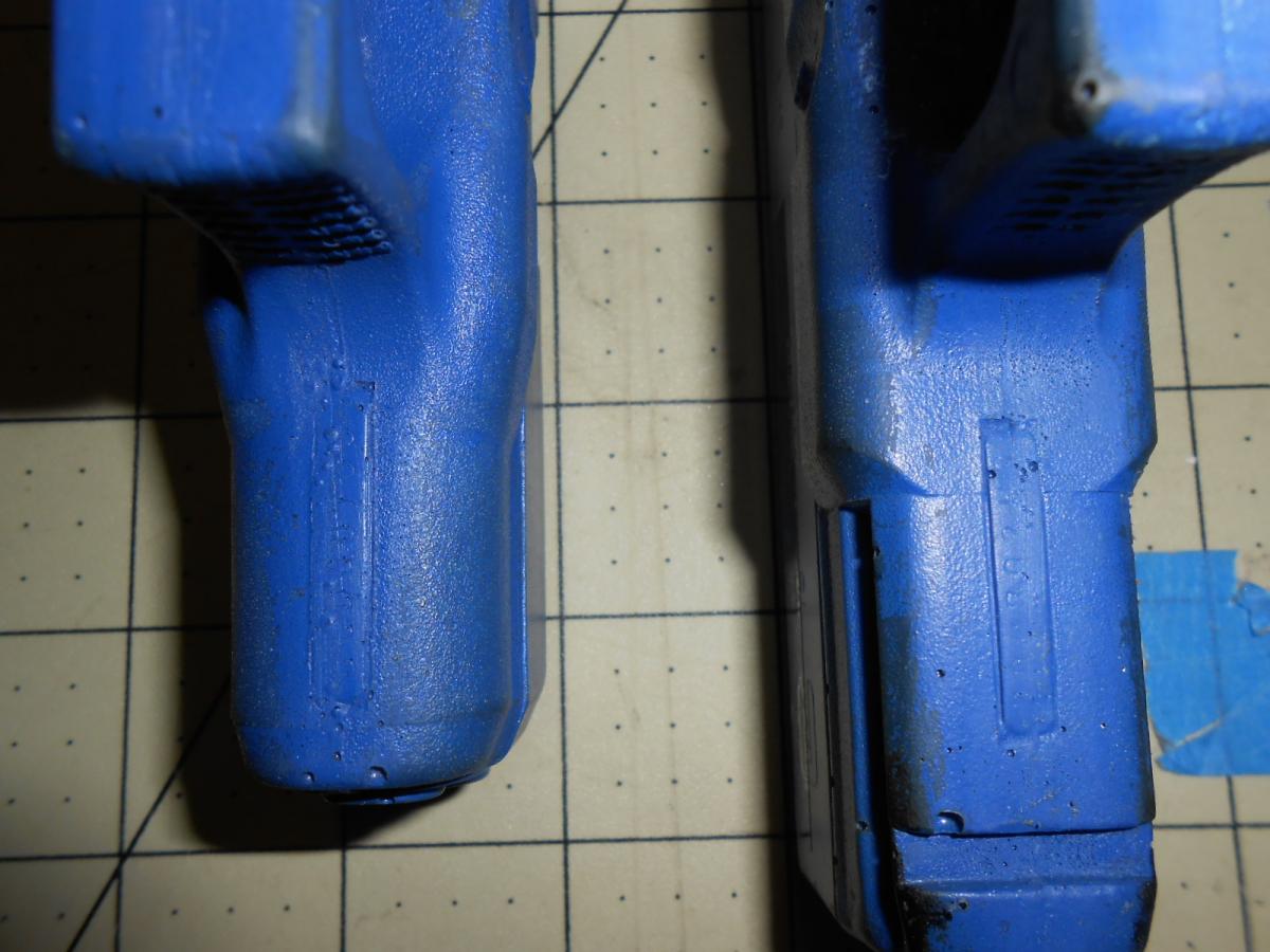

Glock 27 From A Glock 19/22/17
Ken G replied to cleanview's topic in Gun Holsters, Rifle Slings and Knife Sheathes
The G27 will fit in a holster molded from a G19, maybe a little loose, but not vice versa. Besides the bevel to the slide of the G26/27 the bevel of the polymer frame is different on the smaller models. On the 26/27 the frame is beveled immediately in front of the trigger guard and the bevel on the 19 is about 3/8" forward of the trigger guard and has a steeper profile. Also, since the 26/27 has no rail the dust cover area is rounder than on the 19. -
