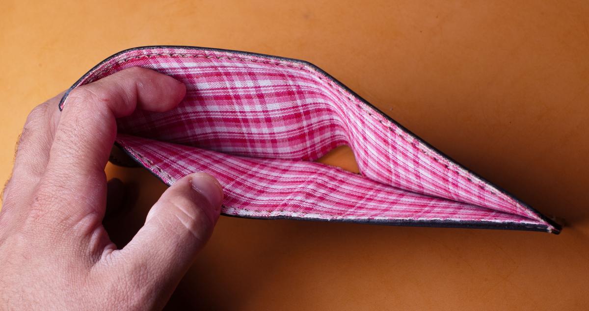

  19. The best way I have found is to fold over the edge of the fabric on itself. You can do this by covering up a 1/2 inch strip at the edge and then applying your glue. Then you can stick the fabric to the leather. Then you can trim the fabric to a 1 inch strip along the edge and fold it in half. This will then be glued to the 1/2 inch strip you left unglued. I hope that makes sense. I have a picture of a lined wallet I did this way and it turned out quite nicely (I think).
