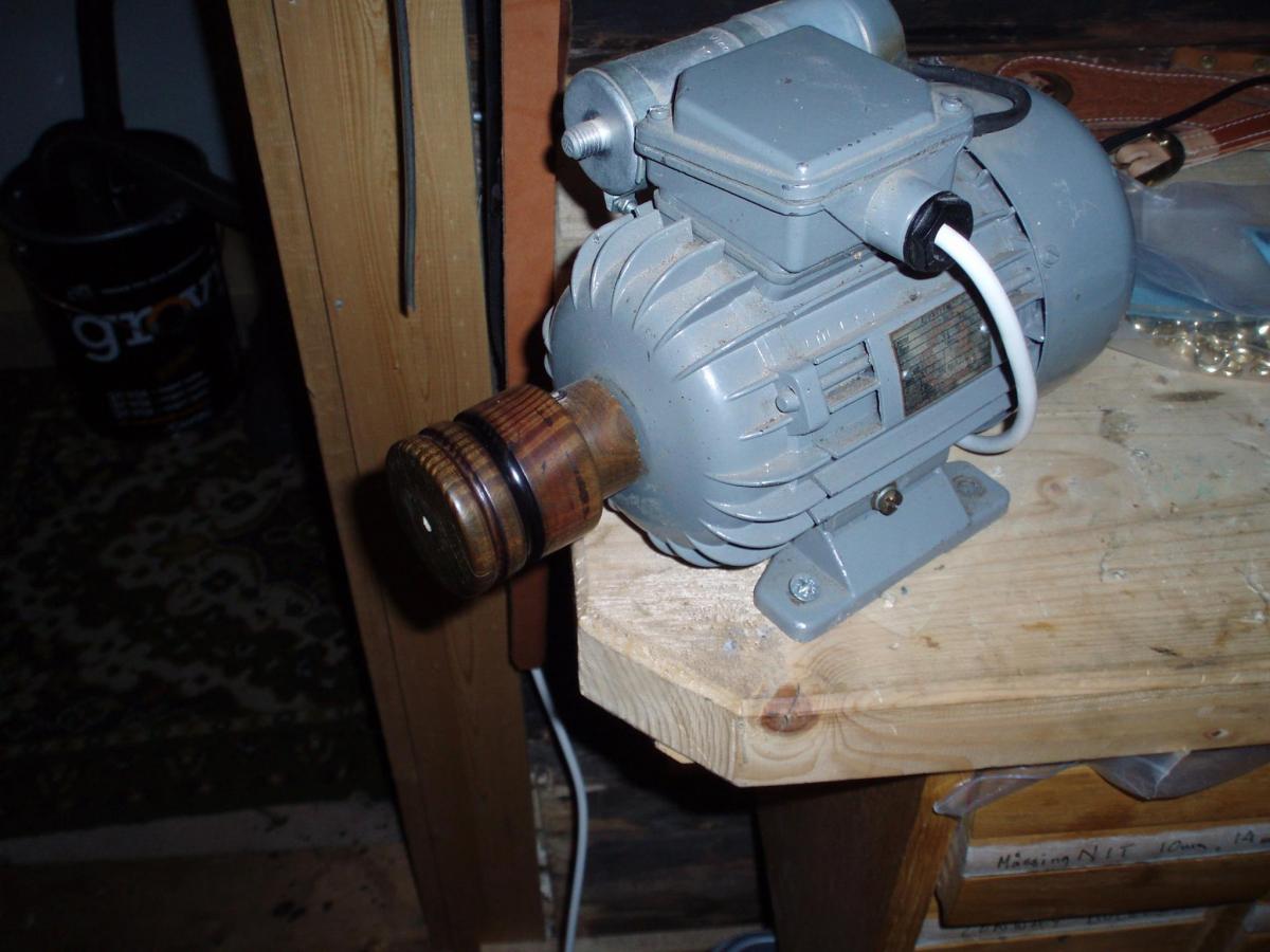

  19. This is my edge machine. I turned a piece of Lignum Vitae to fit the motor shaft. The wood is so hard thet I even could thread the hole for a screw into the axle. / Knut
