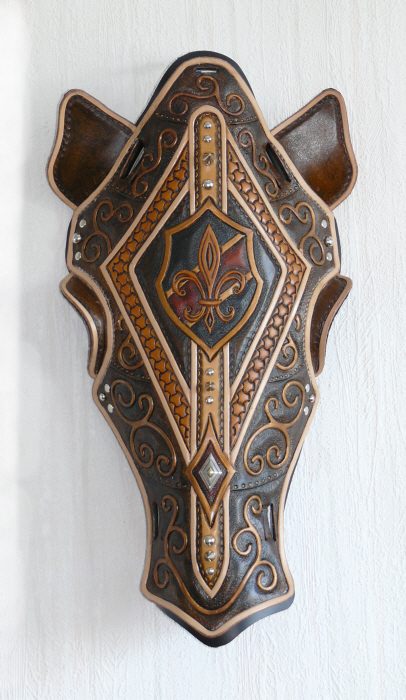

I use a product made for artists called "Art Masking Fluid" ( http://www.misterart...king-fluid.html ) It's like a latex fluid to paint where you want the block, at least 2 layers, comes in a yellow hue or white, same difference. It needs to totally dry befor you start dyeing carefully (be carefull not to rip the edges up). After the dye is dry you just drag the masking fluid away...It's like a rubber surface by this time. I have not used it on any other dye than Angelus and the old type Antiquing from Tandy and it works great. Make some testpieces and make sure you paint the surface you don't want dyed thurroly, you do need a steddy hand. I clean the brushes with white spirit. In the picture...All naturall edges/bands is blocked this way. -
