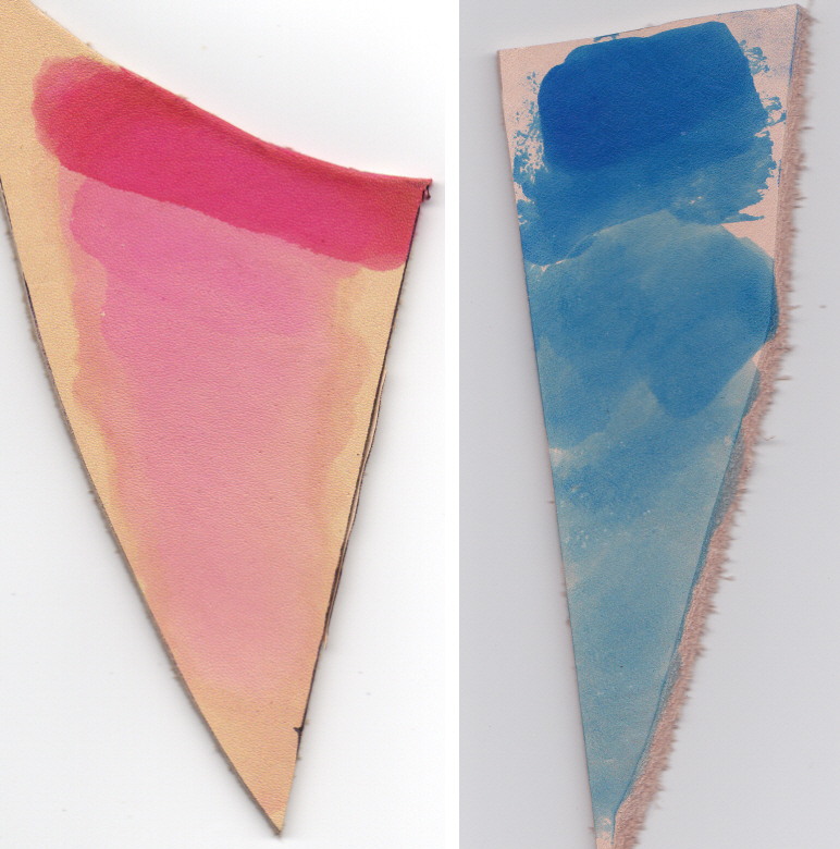

  2. My way it to use a plastic coated paper plate, I put some dye in one end and some spirit in the other and mix them with a brush somewhere in the middle. I have diluted it maybe even more than 1/10. Built it up layer by layer intil you're happy with the shade and let it dry in between so you can see the results, a hairdryer comes in handy. I enclose a picture of some of my experiments with the dye :-) (Angelus spirit dye)
