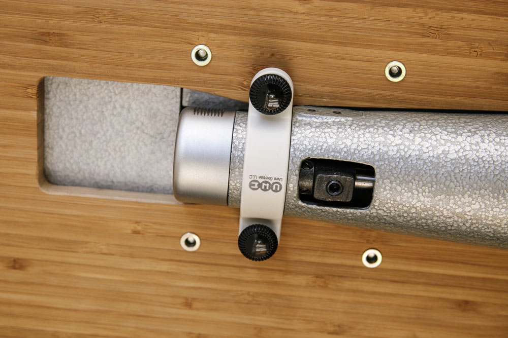

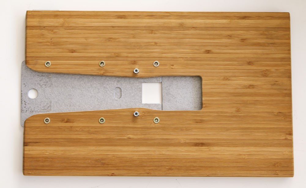

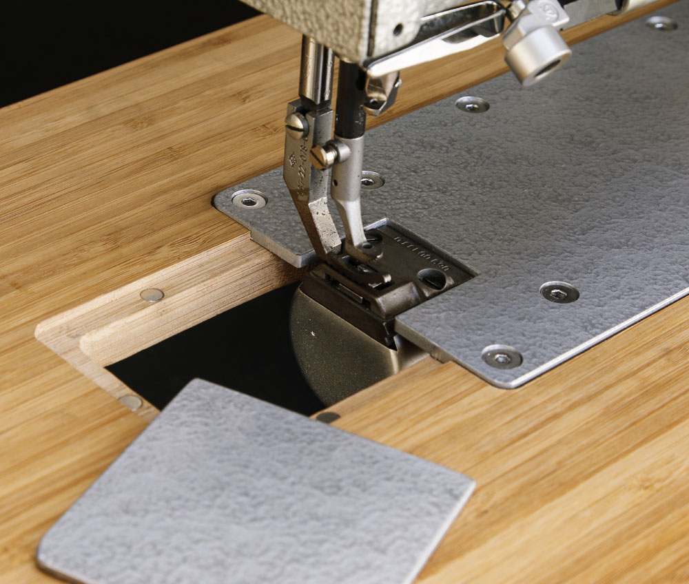

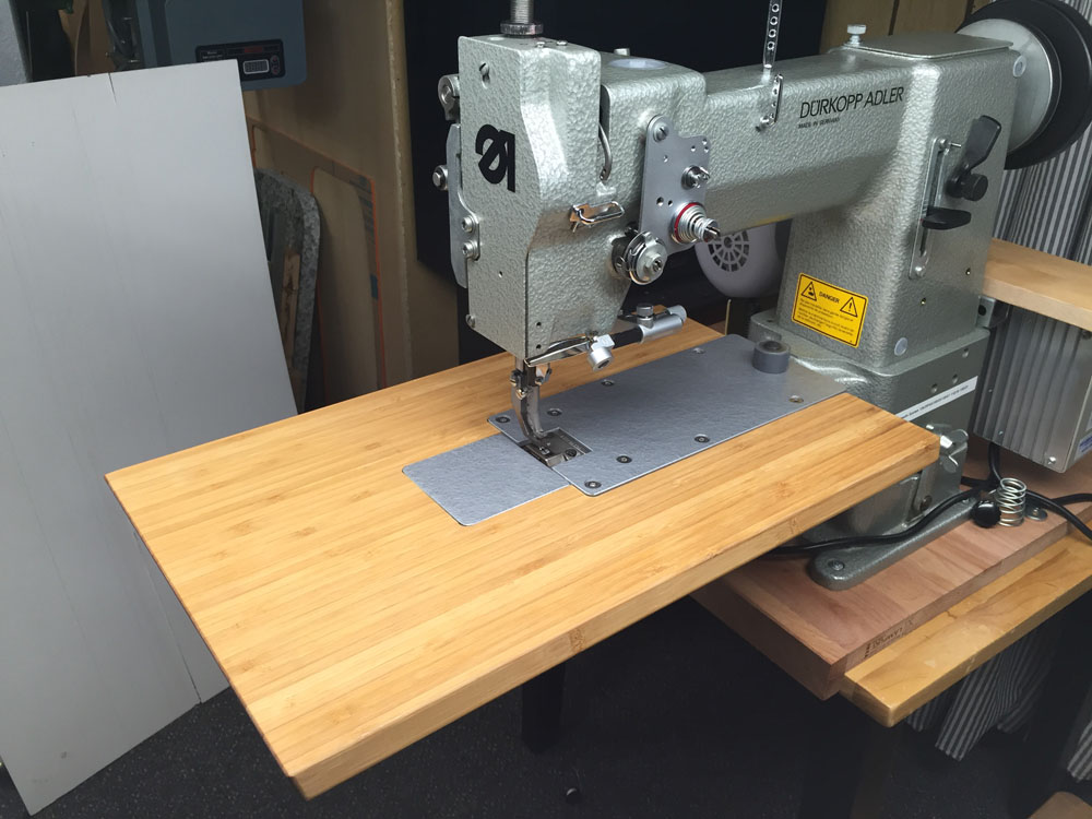

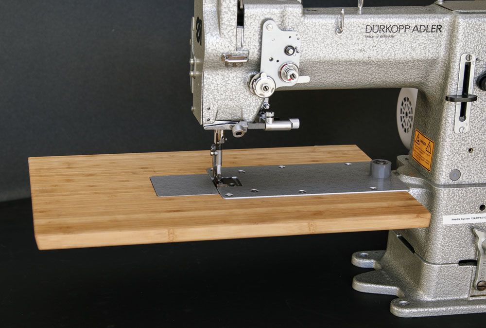

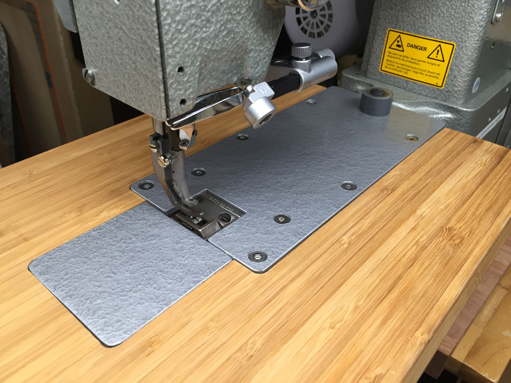

Here are a couple more detail shots of my flatbed table attachment for the Dürkopp Adler 69 class of machines, for the LW archives. -
