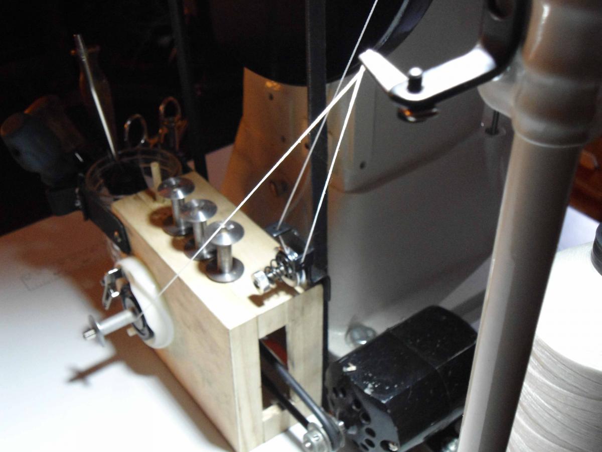

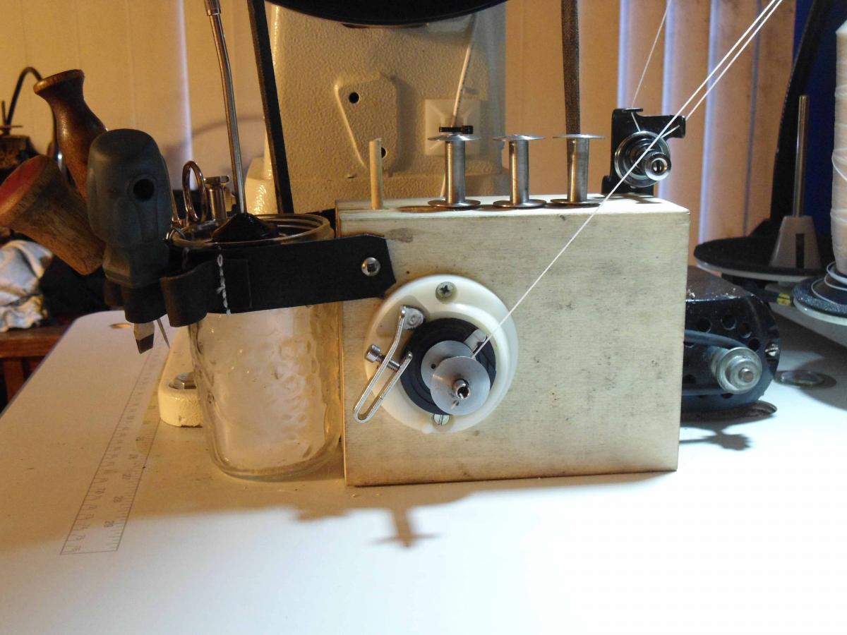

The old finger pressure thread tension device....How deep is the thread groove in your thumb and finger?? For bobbin winders, there are other designs out there, which are great, well built, and work perfectly, however they were designed from a marketable product standpoint. Catalog parts in a repeatable design. Or a diy recipe. Buy this list of parts (or a kit), put together this way and you have your device. This is a good way to go for alot of people, and is a common maker scene methodology. When I designed mine, which i had in my head before the machine even arrived, i knew a couple things: -441 clones have different bobbin winding setups depending on brand. -Bobbin winders differ between machine batches within a brand -The bobbin winder drive design on a 441 clone is less than stellar. Adjustment is a pain. Mis-adjustment is more of a pain. - Even simple electronics are confusing for many, however if you can't figure out how to plug a home sewing machine motor in and make it turn, i can't help you. These were designed with the stereotypical 50's housewife in mind remember....... Because of these inconsistencies, flexibility and adaptability of the design was key. This design can be altered sooooo many ways to accommodate different machine architectures and artistic flairs. I think a lunchkit would be a cool option for the box...... I made this with a balsa box from the dollar store, an xacto knife, some glue, a drill and a few screws. The bobbin storage on top i cut pieces of dowel with wire cutters and glued them into holes. Hole for bobbin winder? hacked out with xacto. Motor and belt are your problem, I suggest craigslist or the thrift store. Sometimes whole machines are worth it for the motor and pedal. These motors make nice burnisher motors for diy burnishers for small items. Much quieter than a hunk of wood spinning in a dremel..... I have better tools and know better techniques, but this does not help the average crafter. Btw, this is how I covered the hole: And while test stitching, I made this little thread nipper sheath I screwed onto the machine where the bobbin thread guide was: -

It seems that a few of us members, specifically Uwe and Dikman and myself have been independantly working on external bobbin winders simultaniously. I got my Techsew 5100 10 days ago and after I ran out the first bobbin and looked at the machine and realized that I would have to have 2 spools of every colour, or wind bobbins with the rest of the machine hammering away at thin air, wearing itself out to fill a bobbin.......There had to be a better way. I give you: Stand Alone Bobbin Winder Tinker Edition. Specs: All factory bobbin winder parts used unmodified. Can be returned to factory in 10 minutes. Stops when bobbin full. Hands free variable speed control High speed bobbin filling. Less than 10 seconds at full tilt with 207. Very inexpensive. Box cost 2 bux and the sewing machine motor and pedal was free. First thing i did was look to see how the factory bobbin winder was driven, as i wanted to utilize all of the factory bobbin winding parts. I found that the rubber o-ring tire was mounted on a round belt pully. I just so happened to have an external electric sewing machine motor, footpedal and a rubber roundbelt. I mounted the factory bobbin winder into a wooden box i got at the dollar store for 2 bux I think and then screwed the box to my machine table right next to the belt slot. I then mounted the sewing machine motor behind the machine head onto the tabletop making sure to get the belt tension right so the motor drives the winder properly, but the belt slacks off when the bobbin is full. The thread tensioner is on the back corner of the box. I mounted the thread guide to one of the screws on middle of the the thread stand. This really helps it fill nice to have this further away.Thread path is down from tree, through tensioner, up to stand, back down to bobbin. Gas pedal: Cover made from spraypaint lid, mason jar for oilcan and a scrap strap with loops for tools to hold it together.
