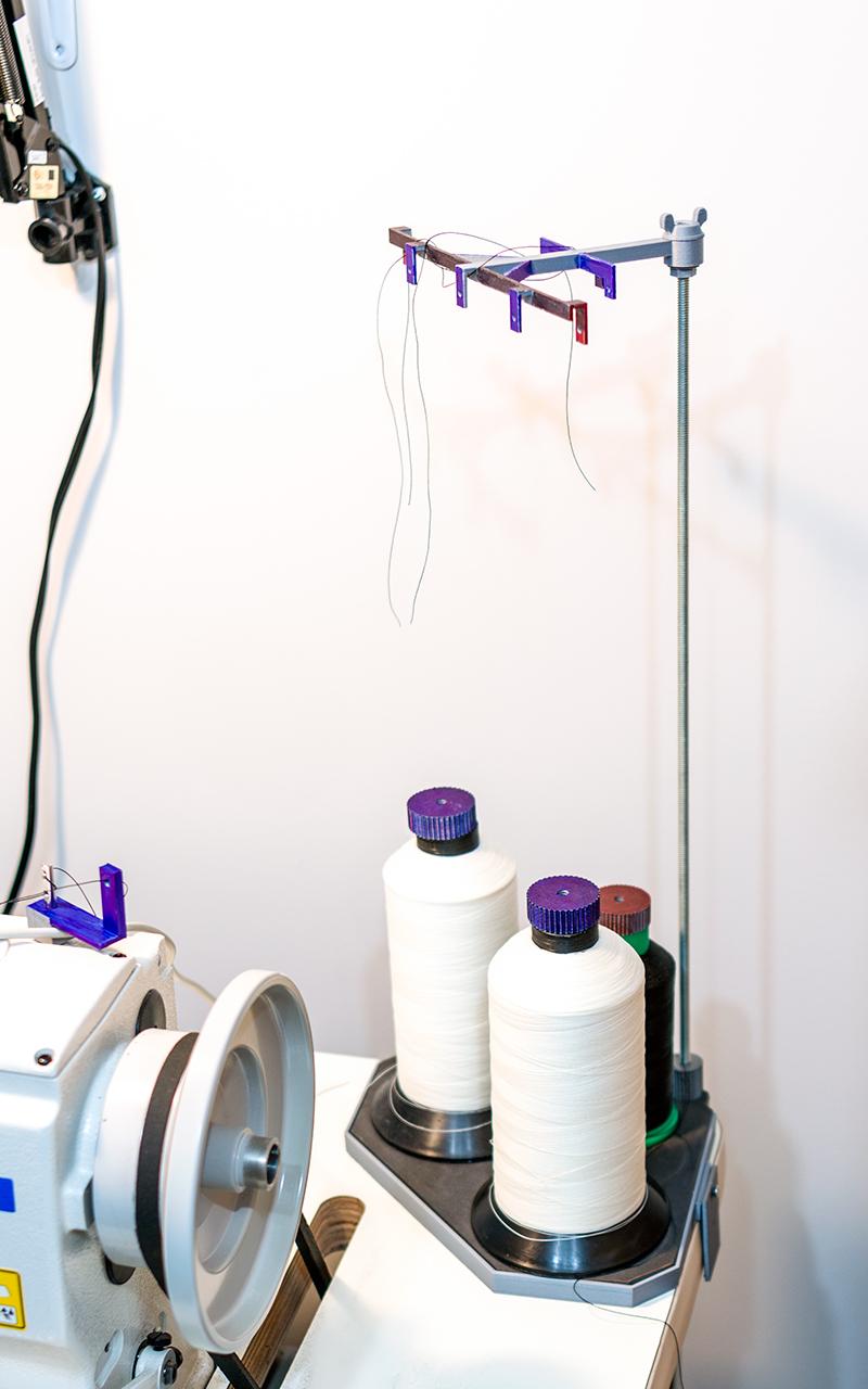

Any chance of a photo's showing the tread path from the spool to the eye of the needle. Also the distance from the bottom of the spool to the thread hole just above the spool of thread should be approximately 2.5 times the height of spool of thread. Are you using a 1 lb spool of thread or 8 oz? Is the thread a brand name or a Chinese brand thread? kgg
