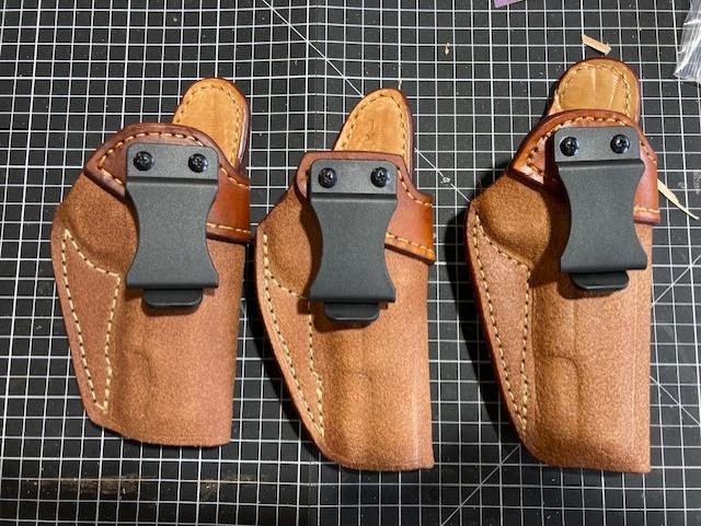

I haven't done many roughout holsters; there's definitely a knack to keeping the look clean and consistent. Larry
