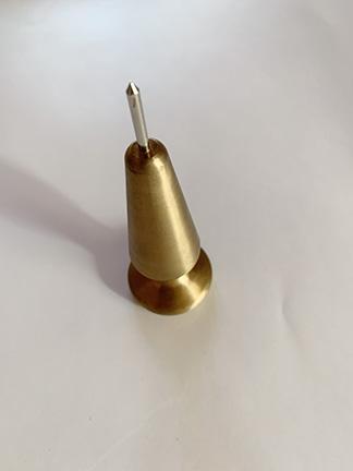

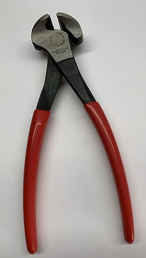

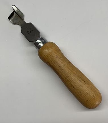

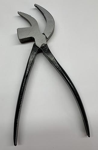

Left handed Shoemakers insole/channel knife made by Tina of Germany. Sells new for $219.00 I am selling new out of box for $175.00 plus shipping New TEKTON TOOLS Nipper/Tack puller Made in USA $20.00 plus shipping NEW - LASTING PLIERS $40.00 plus shipping NEW - BRASS SMOOTHING TOOL. Used for smoothing leather toe area of shoes and heel area. I paid good money for this tool. $25.00 plus shipping More later

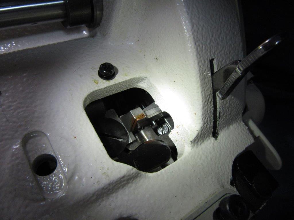

I would imagine that it same as 1541 . there an access plate on backside that you have to get to a screw . It little hidden and you have to look Upward to see it. You have to lift UP the manual press-foot lever to even see and have access to the screw . You also have to make the foot height adjustments with presser-foot lever locked Up position with loosening and then re-tightening the screw . - - - - Today

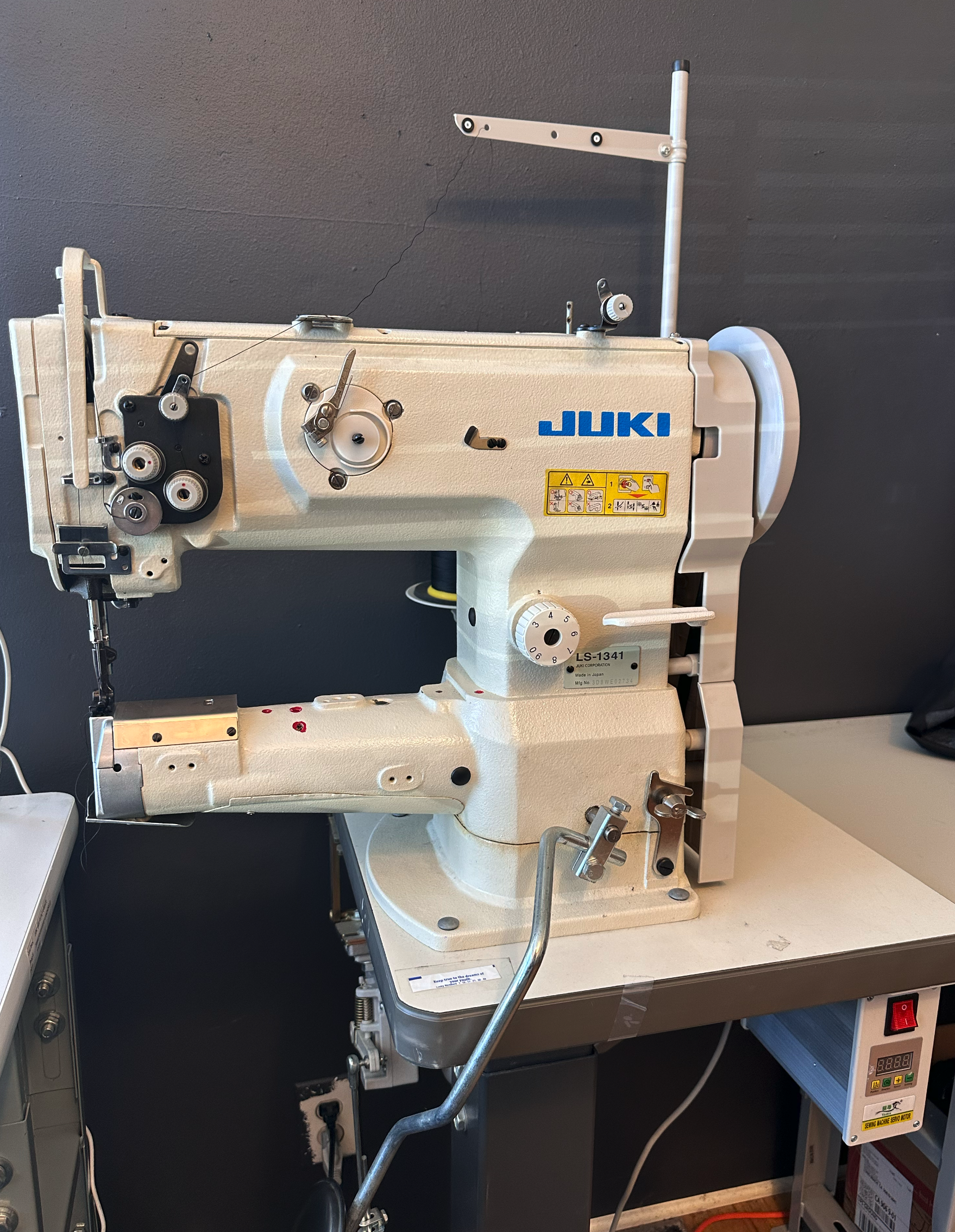

Used Juki LS 1341. Recently serviced and in good working condition. Originally purchased used but I haven't put it to much use. I believe it is equipped with a speed reducer/smaller pulley (forgive me I don't know too much about these). It can sew very slow, controlled stitches. Selling because it's too heavy duty for my needs. I'm hoping to replace it with a post bed machine instead. Asking $2000 obo for head/table/motor. Pick up in Long Beach CA, or can possibly meet somewhere in LA.

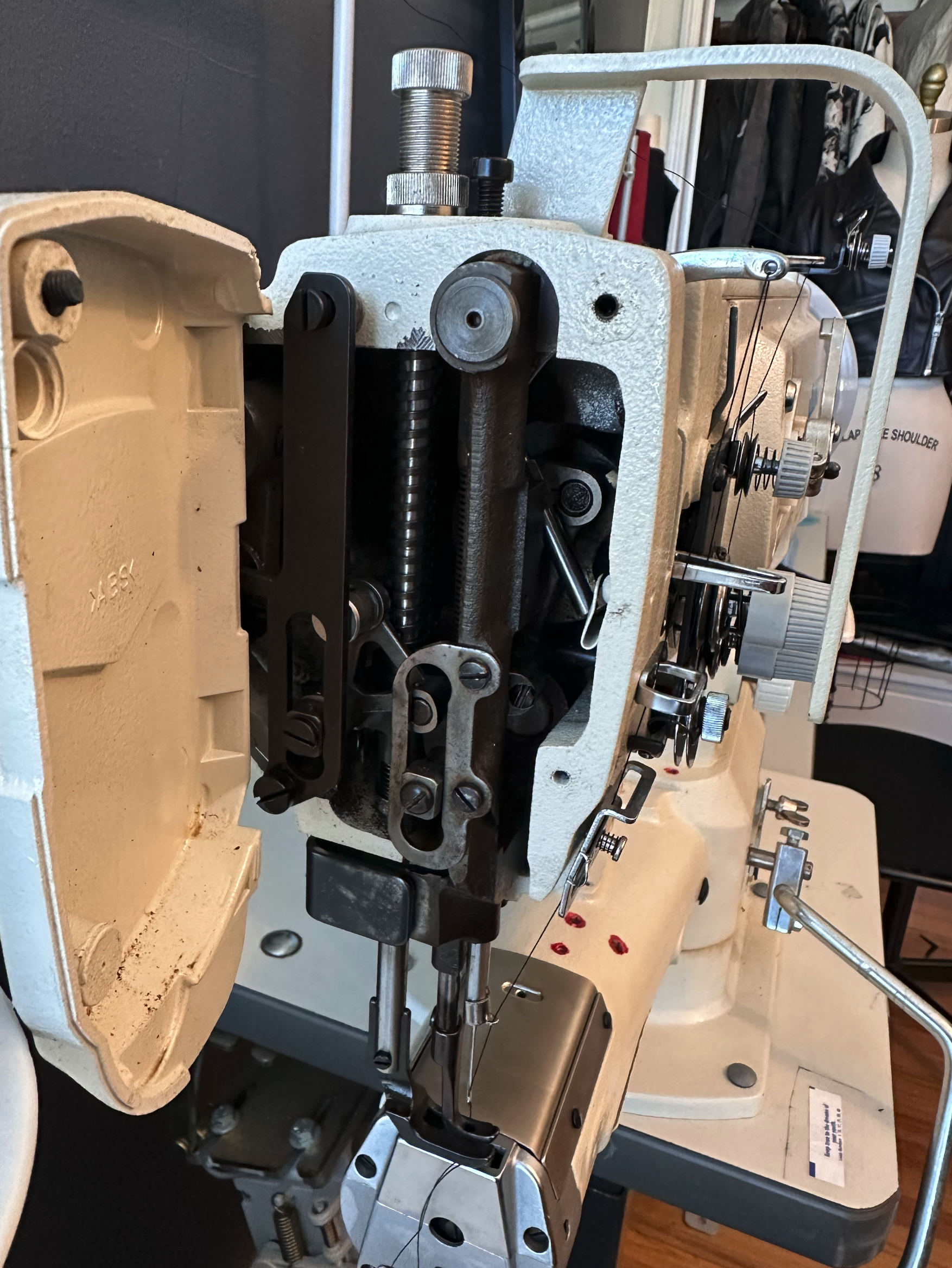

I just picked up a used 1341 and noticed some of material slightly slips while sewing. When the needle reaches the top most, shouldn't the presser foot go all the way down to the throat plate? If so, can anyone help me and explain how to adjust the presser bar to go down?
