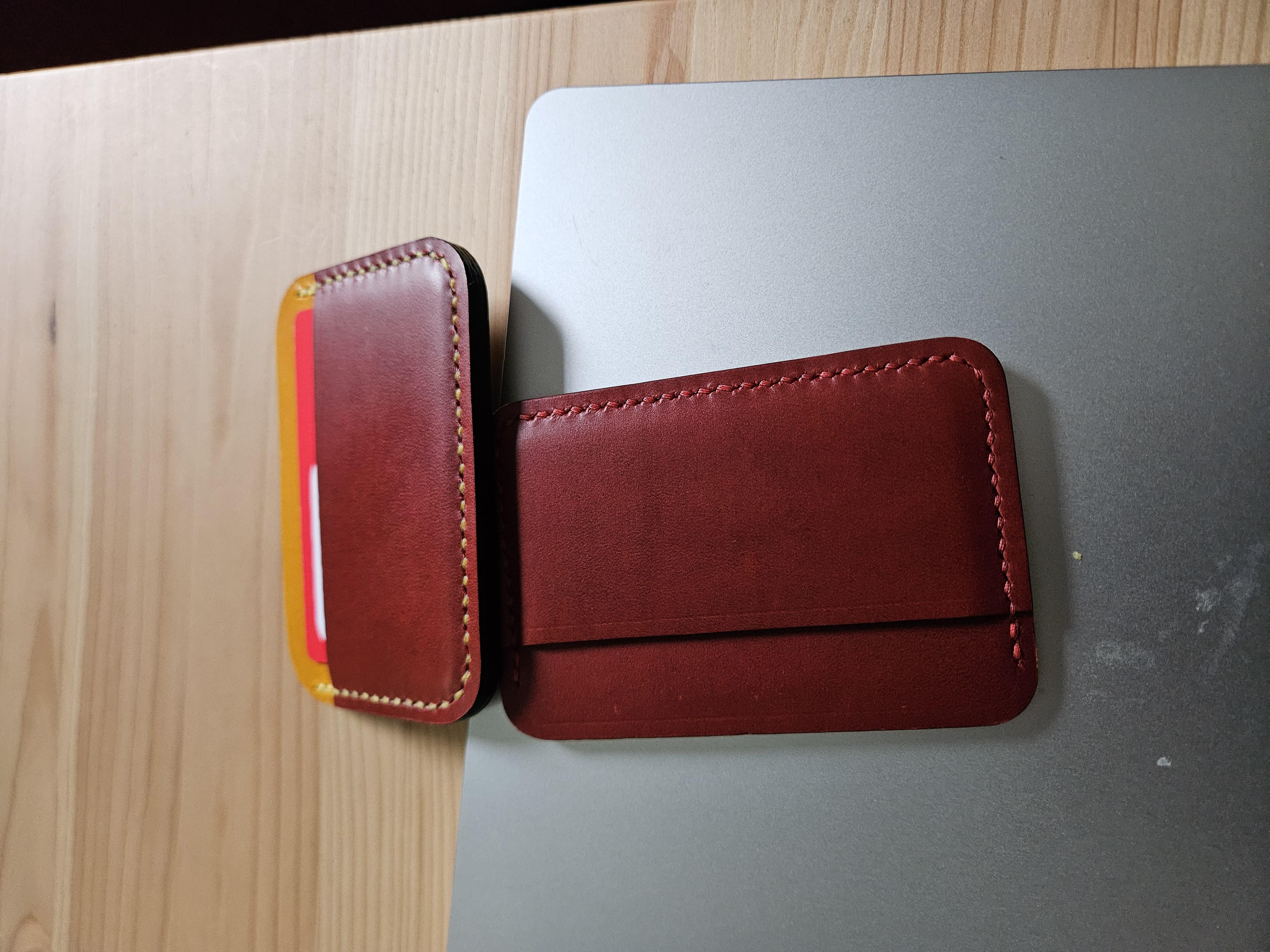

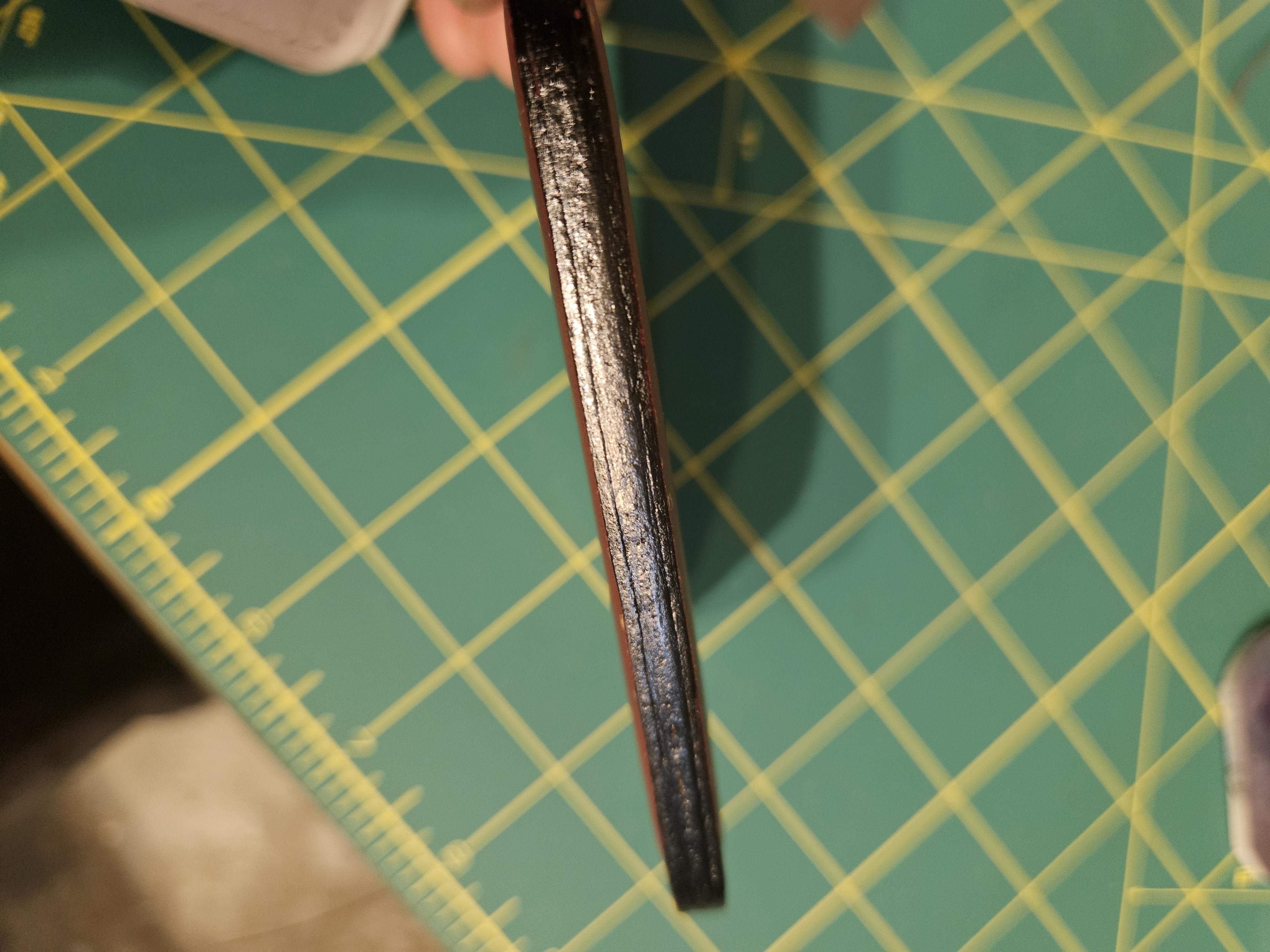

  2. Thanks, no paint just Tokonole and slicking. Thanks, I did this in my next iteration. Does it look better? Thanks, I kinda agree, it really shows it was handmade. Thanks for your feedback, I tried the edge paint in the second version. Next I will try to put some elbow grease in the edge. It really takes a lot of time :).

  16. That is a nice looking glasses case. The edging could have been a little better but I have seen plenty a lot worse. I would not think of making it for under $60.00au which would be about 35 euro. Patterning time will often take longer than the actual job and I do use Autocad and a laser and 3D printing regularly as well. For me I would still be losing at $60.00au but the next time I would be in front.

  18. Thank you for your insights. In my case leatherwork is a starting hobby, so I don't have much experience and most of what I do goes with a lot of thinking, trial & error and experimenting. I also don't have a drawer filled with patterns (yet), so I spend a lot of time designing them. This case was an easy one in that respect because I could base myself on an existing pattern that I could adjust. I'm currently working on a biker's leg bag where I have to design everything from scratch, which seems to have taken as long as actually putting the bag together. At this point in time I'm happy to get material costs covered, plus some extra that I can invest in new stuff. Good point about overheads though; from what I charged for this customer I figure I have my material and overhead costs covered. I don't have to make a living out of leatherwork, I have a full-time day job as well that I won't let go of. I'd have to charge over 45 euros per hour on top of materials and overheads to match my current job's hourly rate and with my current abilities that's out of the question.
