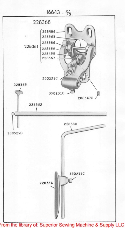

  2. This is the knee lifter I purchased for this machine. It doesn't include the roller you mentioned in the other example.

  5. There should be a push button somewhere on the bed of the machine. You push down on it while rotating the balance wheel backwards until the safety clutch mechanism connects, with a noticeable sound. If the safety clutch engages too easily, there may be adjustments on it to stiffen the action more.

  7. I should have used sticking rather then binding. (knee lift shaft is sticking.) Glad the machine works good with the knee lift. kgg

  17. A Florida State Trooper pulled a car over on US 19 in Clearwater, Florida. When the Trooper asked the driver why he was speeding, the driver said he was a magician and juggler, and was on his way to St. Petersburg to do a show for the Children's Hospital. He didn't want to be late. The Trooper told the driver he was fascinated by juggling and said if the driver would do a little juggling for him, then he wouldn't give him a ticket. He told the Trooper he had sent his equipment ahead and didn't have anything to juggle. The Trooper said he had some flares in the trunk and asked if he could juggle them. The juggler said he could, so the Trooper got five flares, lit them and handed them to him. While the man was juggling, a car pulled in behind the State Trooper's car. A drunken good old boy from New Port Richey, Florida, got out, watched the performance, then went over to the Trooper's car, opened the rear door and got in. The Trooper observed him and went over to his car, opened the door asking the drunk what he thought he was doing. The drunk replied, “You might as well just take me to jail, cause there ain't no way I can pass that test!"
