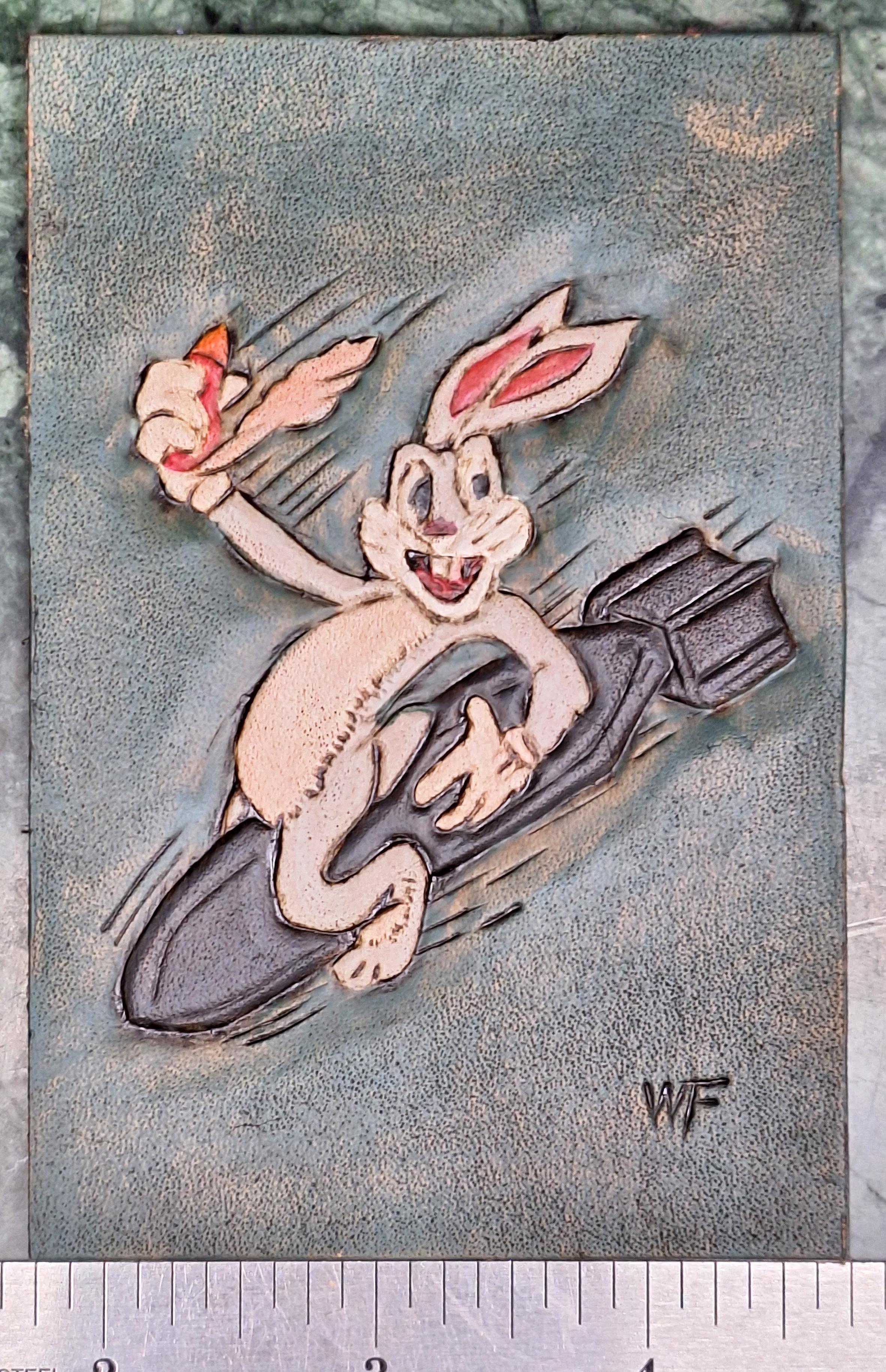

    The Alamo
    Worked on a WWII nose art trading card. There is so much inspiration for tooling in that genre.
