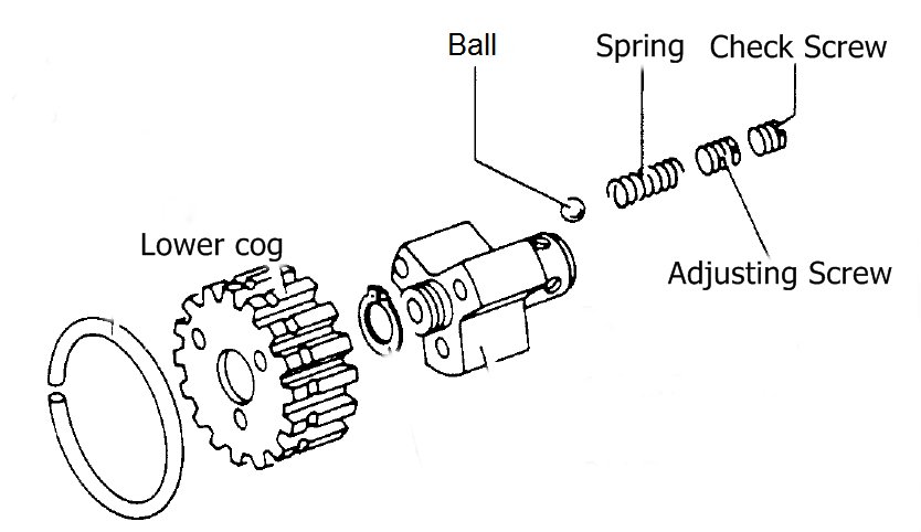

Need 211W155 Stitch Length Adjusting Help
Gregg From Keystone Sewing replied to jdnbr's topic in Leather Sewing Machines
See attached image, I think a stitch length regulator/safety clutch parts breakdown is on order. Remove all check screws first, adjust for spring/ball pressure, then reinstall check screws to lock settings in place. If this mechanism appears to be new and not so improved over the preceding 111W stitch length and safety clutch reset system, you are not alone. These units are prone to give service issues. To make matters worse, this setup can easily confuse an operator when they are resetting the clutch or m, but most likely when they are adjusting stitch length, but that's even when it is working correctly. The issues compound when this unit needs to be cleaned and readjusted over time. -
