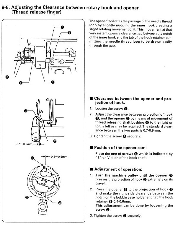

1541S Basket & Opener Adj.
Gregg From Keystone Sewing replied to brmax's topic in Leather Sewing Machines
See attached, this explains this better, but for a Consew 206RB style machine. Adjustment is the same, hope this helps. -

See attached, this is how handwheel should appear, with both white dots aligned to remove the bobbin. That's what these marks are for. They are fixed on the handwheel, and the handwheel is fixed by set screws on a v ditch and slot. Older 206RBs had the dot on the handwheel with an adjustable ring. In addition, the feed dog carrier could be a hair too low, and impeding the bobbin case from coming out as well, but this is a sensitive adjustment that can easily be too high or too low.
