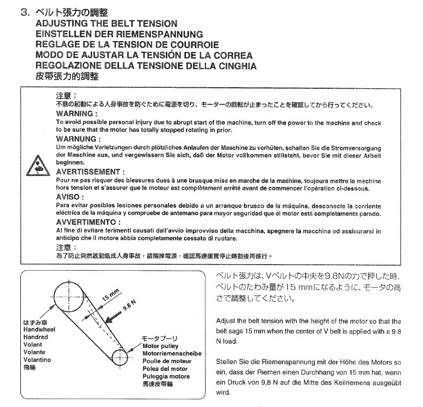

See attached. I've never used this or needed to; after a while, we do it by feel. But, if you don't know what is too tight or too loose, here is a baseline guide. Too loose, the belt will slip. This is not a timing belt or chain on an engine; you'll never damage the machine by slipping the belt on the pulley if it is too loose. Too tight, at the motor can jack rabbit start, as where you push down on the motor treadle and the motor goes from zero to 60 with no control in between. This can also put excessive load on the machine and motor pulley and prematurely wear out these parts.

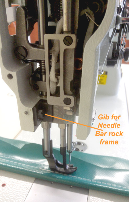

Just to follow up a bit and add to Wiz's comments, see attached. This is an example of the climb adjustment found on many, many walking foot machines. Older Singers have a fixed hinge screw and a worm gear eccentric that rides across the top shaft in some cases, but again, same thing. Some machines have a large mechanical dial on top to perform the same adjustment that is easier for the operator to adjust on the fly. In addition to all that, there are electronic solenoids or pneumatic controls that can do this automatically when certain conditions are met on the programming of the control box, or where the user can push a button off or on for preset settings that are higher or lower foot lift. -
