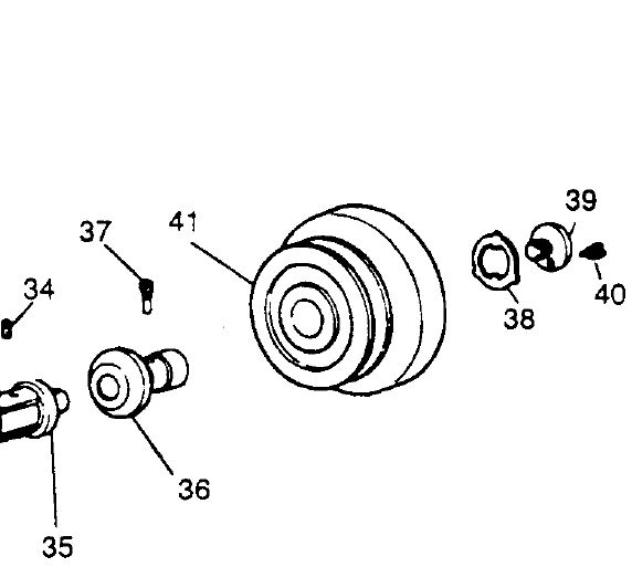

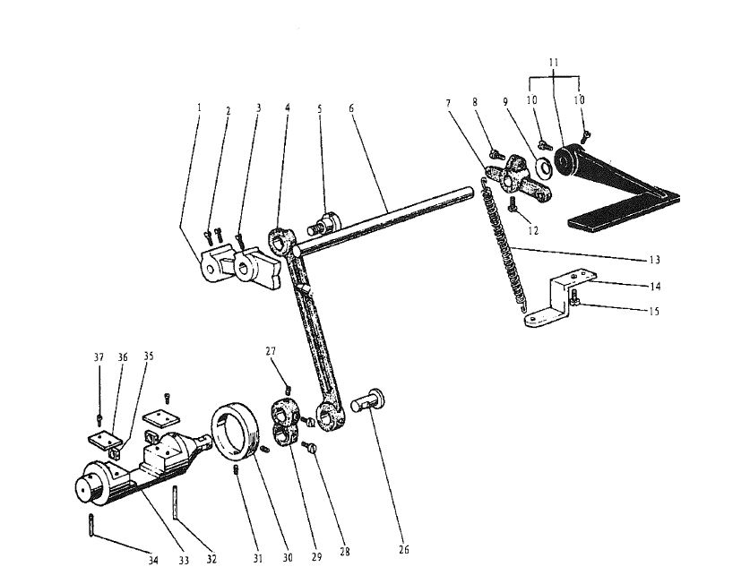

Clutch Motor Reapir Help
Gregg From Keystone Sewing replied to melliel's topic in Leather Sewing Machines
See attached, Like said before, it's almost for sure the hand wheel / bobbin winding mechanism that is the culprit. -
