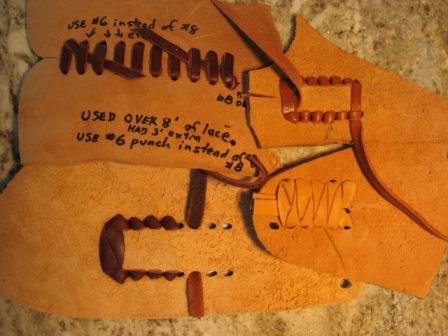

I tired posting photos earlier to show how to practice lacing and the different styles of lacing patterns, but my photos were too large in size. Hopefully these will give some idea of how I've practiced lacing before trying on the finished product. One picture shows the front of the braid, the other shows the back. Ron -

I'm too lazy to walk to the shop and check Stohlman's Book, but I recommend practicing on scrap leather first, and try differenet patterns before jumping into lacing the fork cover. With that said, I'd recommend using 3/8" lace made from latigo leather. Split it down to about 2-3 oz. and bevel the edges. Now, saddle soap the string and rub the heck out of it. When you think that it's good, apply some more saddle soap and rub some more. Stohlman suggests punching your holes a little less apart than the width of your lace. This is okay if you're a pro, but it risks splitting the leather out between the holes when pulling the sting. Good luck, -
