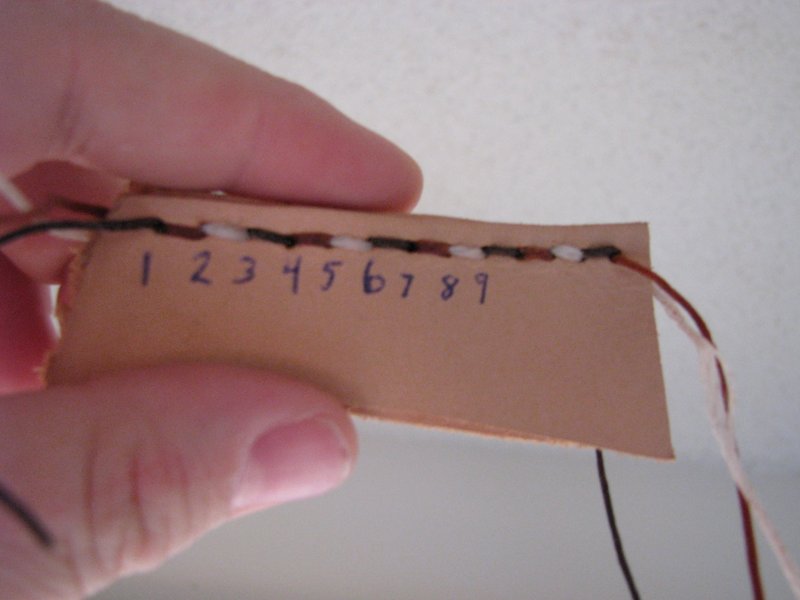

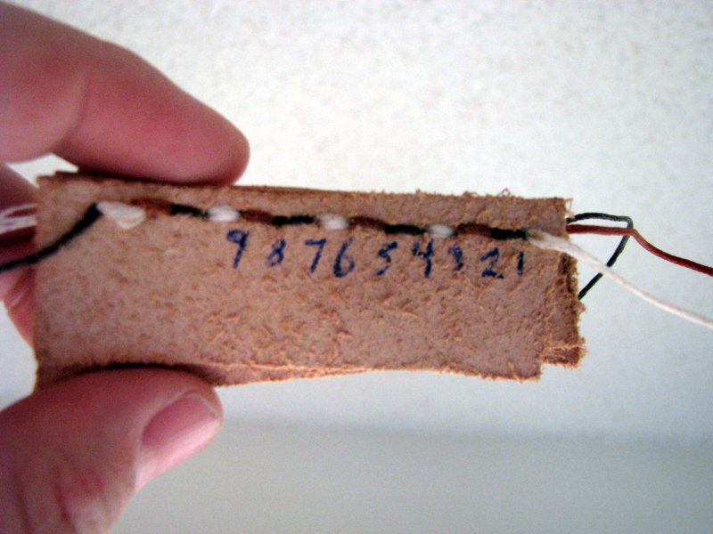

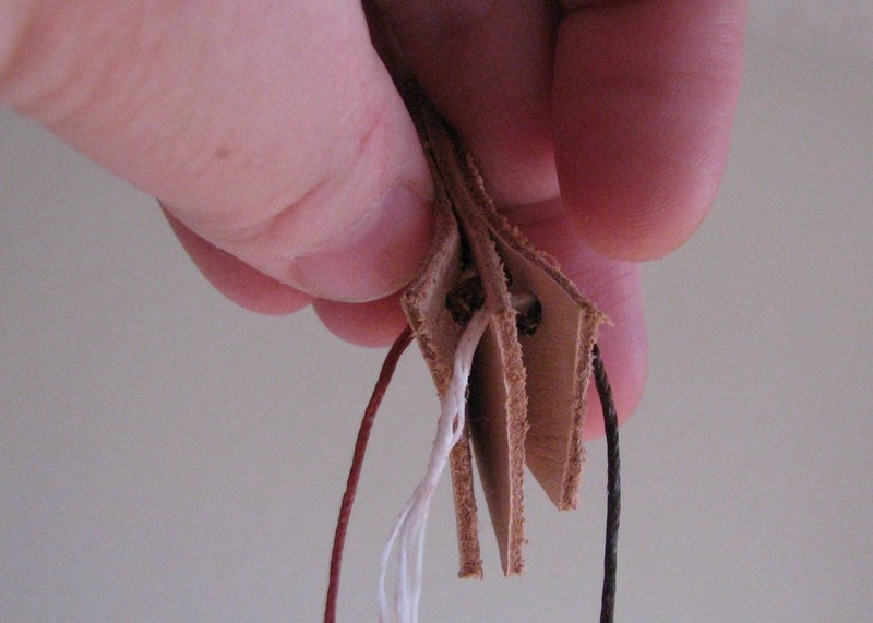

  4. Ok, maybe this will help. Excuse my stitches, I wasn't exactly 100% awake, so I wasn't terribly careful about which thread was on top of the next, so they're a little wonky. This is where you can hide the threads in the welt, so you show three-colored stitch on the front, and a three-colored stitch on the back. It's not exactly a saddle stitch, more like a backstitch crossed with a saddle stitch, and likely a weaker join overall than a saddle stitch. I have three layers of leather in this example. The top (T), the middle or welt (W), and the bottom ( . For this, I stacked the pieces all grain side up, but you could certainly have the outside layers both grain side out. The three threads are called White, Brown, and Dk. Brown in the directions below. Now, the hidden threads in this example lie between the welt layer and the top layer, but could just as easily lie between the bottom and the welt. You can cut a groove to hold the bulk of the hidden stitch in the welt, or if you are using two layers to the welt, you could cut a groove into the sides of the welt that face each other, making a hidden channel to hold the threads. To start, I ran White from the backside through the first hole in the bottom layer (so hole B1), the first hole in the welt layer (W1), and the second hole in the top layer (T2), then down through all three layers at hole three (T3, W3, B3). The Brown cord starts in the welt, and goes up through T1, then down through T2, W2, B2. The Dk Brown cord starts at the top and goes down through all three layers in the first hole (T1, W1, B1), then up B2, W2, T3, down T4, W4, B4. The White cord goes up through B4, W4, T5, then down through T6, W6, B6. The Brown cord goes up B3, W3, T4, then down T5, W5, B5. Dk Brown goes up B5, W5, T6, then down T7, W7,B7. White goes up B7, W7, T8, then down T9, W9, B9. Brown goes up B6, W6, T7, then down T8, W8, B8. Dk. Brown goes up B8, W8, T9, then down T10, W10, B10. And etc. Front or top view. Back or rear view. View of hidden stitches between the welt and top layer. The top layer is to the left.
  5. If you're using a welt, you can run the extra thread between the welt, so you only show one thread front and back, albeit each stitch on both sides will show in different colors.
