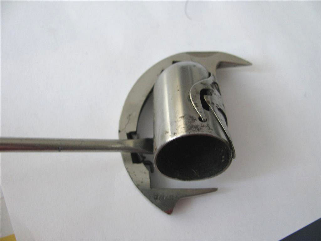

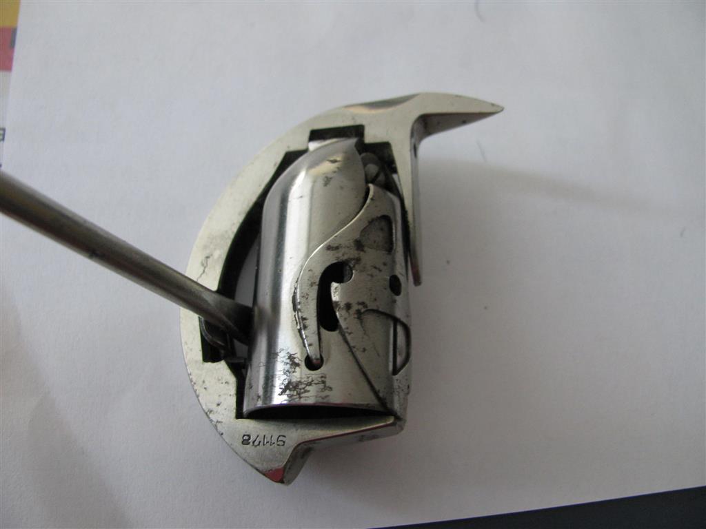

Black Dogg - I´m not a dealer, I´m just selling extra parts from time to time to get in some play money for my sewing machine hobby. I have no Adler 30 parts. Are you using the correct needle system? Machine needs a System 332 / 29x3 needle or alternatively a 135x17 needle (both ~45mm long). if you have a 332 / 29x3 needle then the short grove should face straight RIGHT and if you have a 135x17 needle the scarf should face straight RIGHT. 1.) I´d try to move the needle holder a bit to the right so the needle is a bit closer to the hook. Loosen the screw above the needle screw and move the entire needle holder a bit to the right but make sure the needle will not hit the needle plate. 2) check the hook timing (see manual) 3.) check if the hook tip is work is worn. If so you can compensate that a little bit by adjusting the timing (see hook timing in manual) 4.) check the condition of the small spring in the shuttle driver. It should gently touch the hook and push it against the gear box (hope you know what I mean) If the spring is worn (should have a nice smooth ball on the tip) I´d replace it because a worn tip may shred the thread sooner or later. If you need a new hook or the small spring they are the same as for the Singer 29K71 / 29KK73 so they should be available at most of the known dealers or even on Ebay. Hope this helps A non marking foot is almost impossible for the machine because it is a top feed (no feed dog or needle feed) machine so it needs the teeth to move the material but you could try a piece of heat shrink tubing. This is nothing permanent and if it does not work for you you can easily remove it.
