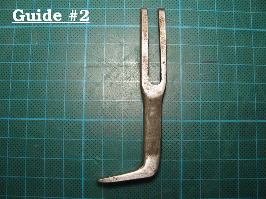

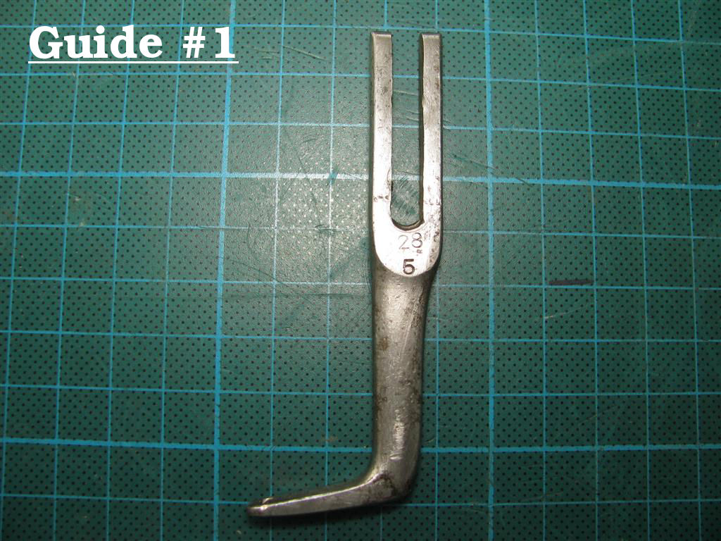

I guess the needle bar is the same as for the Adler 105 (I guess) so probably a needle bar of an Singer 45K would fit as well. The 45K needle bars are 9.5mm / 0.375" in diameter and 26.2cm / 10.31" long. Maybe that will help you a little bit when you want to go from 2 to 1 needle. I also have a Singer 45K needle bar some edge guides and so forth - just for the case you need something -

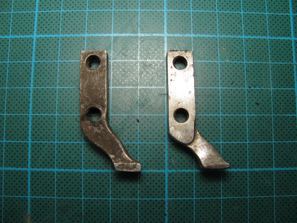

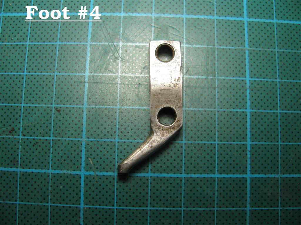

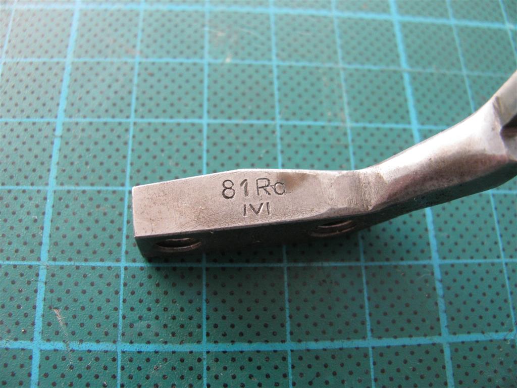

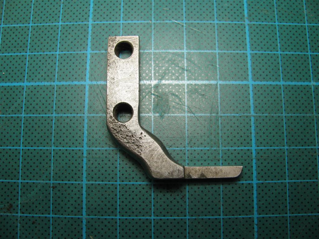

I have a couple of feet for the Single needle Adler 20. If you are interested send me a PM -
