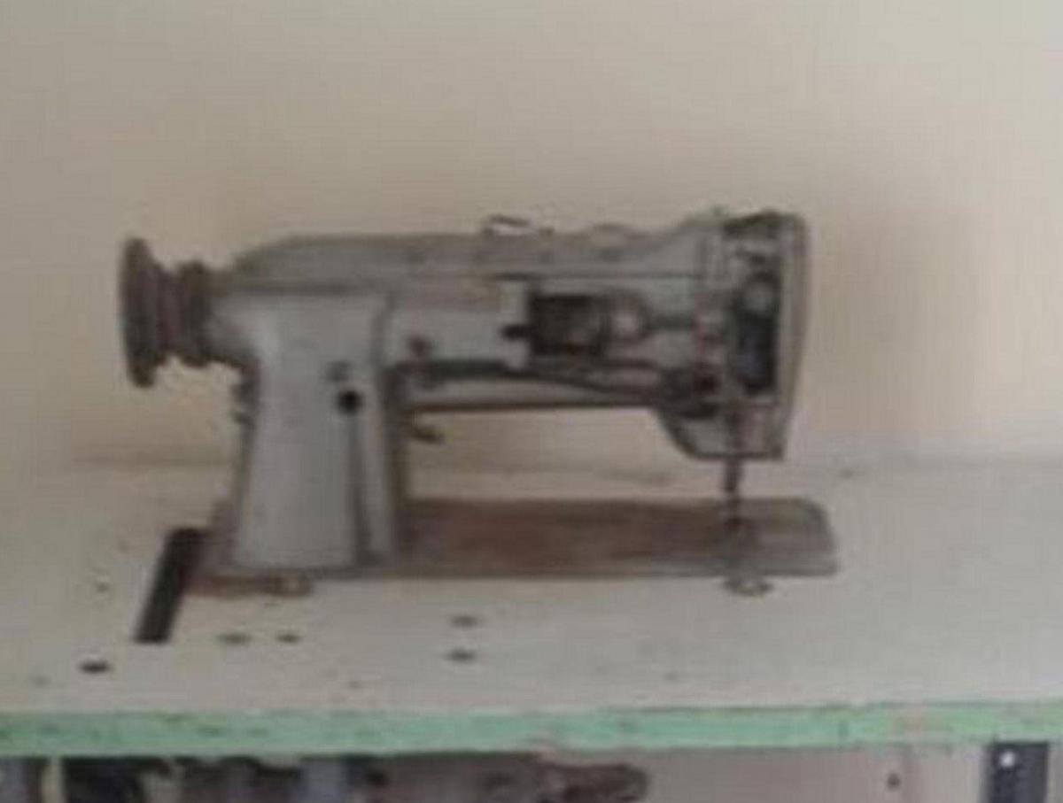

Operators Manual For Singer 45K76
Constabulary replied to Jwfarms's topic in Leather Sewing Machines
Now thats a fly whee / pulley . Machine over all looks not bad - not very much dirt and oil gunk as far as I can tell and all parts seem to be present. Have you sewn with it? Anyway, I´d clean and oil it thorougly and keep it well oiled! EDIT: BTW - what I don´t see is a bobbin winder.
