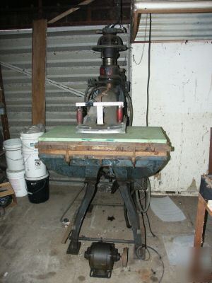

Good going. It will make your shop. There are some parts missing I have enclosed a photo of what is missing from the cutting table. I hope the photo is large enough to see the missing parts. There is a steel frame around the backing board that is bolted to the table also. There is a backing board on your's but it is made of plywood and lacking the steel frame and hold down parts. You can turn the machine into single phase without to much trouble. It maybe easier said than done but all you need is a single phase motor and an electrican to rewire it. Good luck to you.

The pressure on the machine arm is around 15 to 18 ton. It is almost identical to the United Shoe Machine Model C. The weight of the machine is around 2200 pounds. I bought one for 75 dollars at an auction 5 or 6 years ago. Terrific machine. Parts are available. Good luck getting it home.
