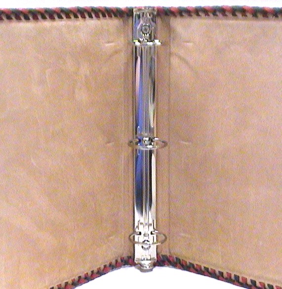

  5. Well, I started this binder 2 years ago as a competition piece. Needless to say, it got put off to the side as orders started piling up. But I finally finished it. So I thought I would share. Design is colored with spirit dye. The inside is covered with a nice soft goatskin suede left in its natural color. The edges are braided in a two tone color with kangaroo lace. the only thing about this binder is there were a couple scars that was hidden on the leather that didn't come out until I put the finish coat on it. (Pisses me off) I put up some pics of the scars, they are not real noticeable, but you can see them none the less.
