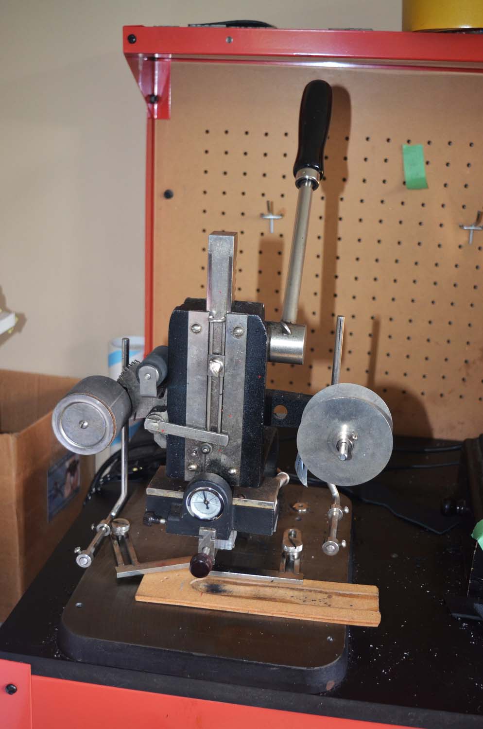

The heat 'softens' leather, especially chrome tan. Chrome tan usually doesn't emboss well without the heat. I find that 225 - 250 F is a good temperature. Higher than that can burn the top finish on the leather resulting in a rough imprint. It takes a bit of practice to balance temperature and how long you press to get an nice clean imprint. You can also use foils to add colour (and foils are available in many colours and textures). Machines can be bought used, I think I paid about $400 for mine. Ebay or Craigslist can be good places to look. If you get some type sets and type holders, you can also personalize items. This is the old machine I use to emboss my logo onto most items I make. Right now it is set up to emboss strap ends.
A hot embossing/stamping machine is what I use. Used ones often can be found, These machines also allow you to use embossing foil to add colour if you like. With the heat, most chrome tan leathers emboss well. The heat will darken light coloured vegitan leather, the logo will be be darker... I usually like the effect. In Canada, I get my dies made by: https://www.sterling.ca/graphics.cfm Look at the magnesium plates, 1/4" deep work well. A plate should last several thousand impressions

I work mostly with chrome tan leathers and emboss all of my products. To get a good impression, you need a hot stamp machine. Both heat and pressure are required.
