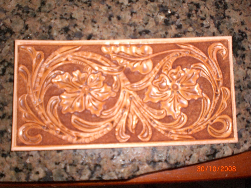

I just finished tooling this portfolio last night at 1am. It has been in the design phase for the last month. It is a commission from a co-worker. I figure I would show it off before I put the finish on. Second, is a money spring wallet that I made for myself. I have finished it or sewn it, but the tooling is done. The third one is my first attempt at my favorite "Bruce J" bag. Yea, I know I have to work on it. I have some changes that I will make on the next one, but this one is done. And finally, a floral wallet back I completed a while back. The finish was two coats of brushed on satin sheet and tan antique gel. Tell me what you think? Thanks. Sorry, too large of photographs. Here is the floral wallet.
I must have gotten the other side of that hide. I took the piece and placed it in my bathtub with cold water and left it there until all of the bubble stopped coming up. I think most toolers will tell you about 5 minutes, but this piece actually took almost 16 minutes before all the bubbles stop. I then set it aside and allow it to return to a natural color. It was still hard to cut, so I stopped and recased it using a forumla I got from the members(here) using Listerine (Thanks Marlon), a teaspoon of neatsfoot oil, several drops of dish detergent (thanks Joanna) and cold water. I cased it good until it stopped sucking the water. I placed it it a plastic trash bag, but I didn't tie it off, I just folded over the end and placed it on my granite piece over night. The next day, I took the leather piece out of the bag and let the leather sit until it turned back to the natural color. I also turned the trash bag inside out to allow it to dry for fear that mold would begin to grow. I could tell that the leather cut better and tooled nice with good burnish. Unfortunately, if you search here, I ended up having some major problems with the finishing. I just threw it away and chucked it as an experience. I ended up taking the leather hide back since I paid more that I thought it was worth and the Tandy Manager was nice enough to give me a credit and allow for an upgrade piece. I think you are right, it is just the process of the tanning. No offense to Tandy because I buy other things there, but I am moving on Herman Oak at $99 a side fo 6-7 oz.
