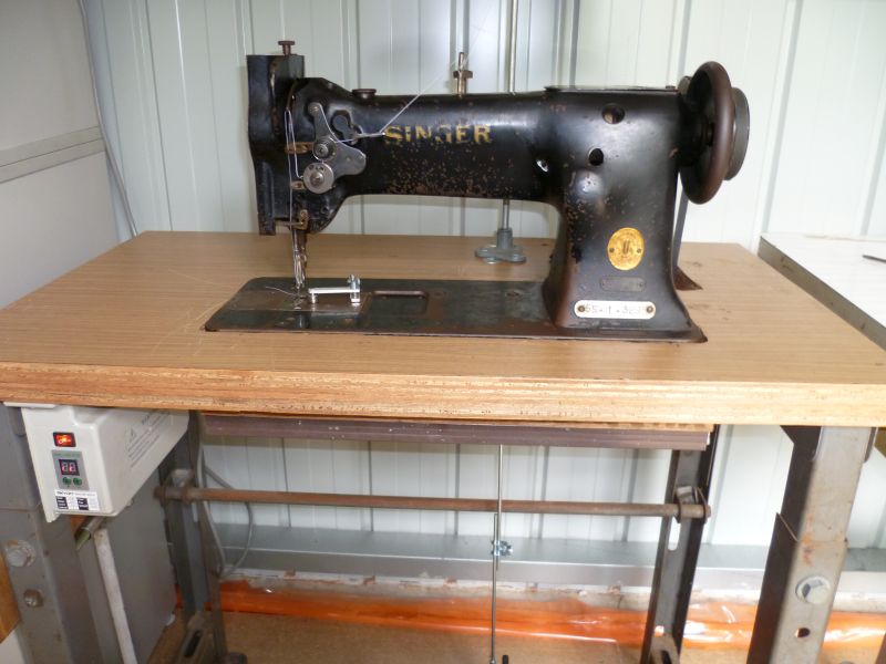

Singer 211 G 466 Thoughts on this one?
dikman replied to cjartist's topic in Leather Sewing Machines
cj, a machine of that type should certainly do what you want BUT (always a but) the knife sheaths may be an issue if you try to make them too thick. While a VFD control is always a possibility if it's a 3-phase motor, as far as sewing machines go the best way is to simply fit a servo motor, regardless of what you buy. For a newbie it will make it so much easier to control the beast! Once you make up your mind to buy one the desire to do so can be overwhelming, but don't rush in. For a first machine you need to know that it actually works so that you don't have to spend time (and money) sorting out problems. There's a lot to learn about these wee beasties and it's much easier if you have a working machine to start with. There's plenty of reading on here to help you understand what will suit your needs, and don't be scared to ask as there's lots of very cluey people on here (not me, I'm still learning!!). -

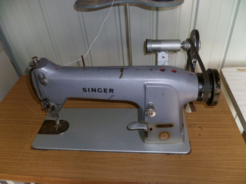

Is a 111w151 OK for stitching dress belts?
dikman replied to leatherator's topic in Leather Sewing Machines
There you go, looks like it should do what you want! Good old Uwe, there doesn't appear to be many machines he hasn't got stashed away . That foot looks a bit rusty, Uwe, hope it's not indicative of the rest of the machine? Leatherator, I forgot to mention a servo motor, if you're going to be sewing leather it's probably the best mod you can do to the machine. My 111WSV77 (which I think is a W153) has about 3/8" clearance under the foot but I can squeeze a bit more under it, although the presser bar/vibrating foot bar need tweaking a bit. It will push a #22 needle through basically whatever I can get under the feet BUT it then needs stronger downward pressure on the presser foot to stop the leather lifting on the upstroke. This, however, is without thread as I use it to pre-punch my holes for handstitching. If I add thread the additional loading can become an issue with stitch formation - in other words I'm exceeding what it was designed for. The mechanics of the 111 class are pretty solid but the real limitations are foot clearance and needle stroke. While they can be tweaked a bit no-one is going to turn a 151 (or 152, 3, 4) into a 155, let alone a Cowboy 3200! -
It's similar to a 211G266 (I think the 466 has a bigger bobbin), which are pretty capable machines, but it all depends on what you want to sew. It could be a good deal if the price was dropped (seeing that it's untested and they can't run it - they're saying that their warehouse doesn't have a 220v feed? Bit surprising for an industrial site). Of course, that assumes the internals are ok. The rust on the handwheel says it hasn't been touched for quite a while and the foot pedal is all rust! Tilt it back on its hinges and look underneath to see if the bits are coated in oil or bone dry and rusting - if the latter then probably go no further unless you know how to rebuild one. If that's ok then try turning it over by hand, it should be fairly easy to turn, and see if the various bits go up and down. Hold down the reverse lever and make sure the feed direction reverses. Try to adjust the stitch length. The switch box on the front of the table looks like it has a cover missing (bit hard to tell), at the very least there's exposed wiring. None of the wiring matters, actually, because the best thing to do is discard the motor and wiring and fit a servo motor, but I'd just tell them that the motor and wiring look dodgy and it's going to cost to fix it. As for referring to the new cost that's irrelevant seeing that you haven't been able to buy them new for a very long time! It's basically an old machine of indeterminate condition (seeing that it can't be run). I figure that you're probably not going to buy it, but this might give you some ideas for any future machines you may look at. -
When you say "adding another foot" I assume you mean turning it into a walking foot? If so, nope, can't be done. The other machines (152, 3, 4, 5) in the 111 class are walking foot, but this one is a needle feed straight stitch. If you fit a smaller pulley to the motor this will slow it down a bit and might make it a bit easier to sew with. If you're suggesting fitting a bigger, stronger motor it's probably not a good idea, as this machine was designed to sew parachute material and if you try to punch through the same thickness of leather (or thicker) then it's probably not going to be a happy machine! It will probably sew dress belts, as long as they aren't too thick, but at the end of the day it's a straight stitch, not a walking foot, so will have limitations. -

Your lever slot looks pretty small compared to mine. I spent some time trying to figure out how to get a longer stitch length but there's no internal adjustment. I did squeeze a bit over 1/2 a stitch extra by filing down the bottom of the silver plate that the adjusting lever moves in. I noticed that the plate was stopping the lever a bit above the cutout in the body, so by filing it down the lever could go all the way to the bottom of the slot. In your case, take off the silver cover and try the lever without it, that will tell you if it will give you any more travel.
