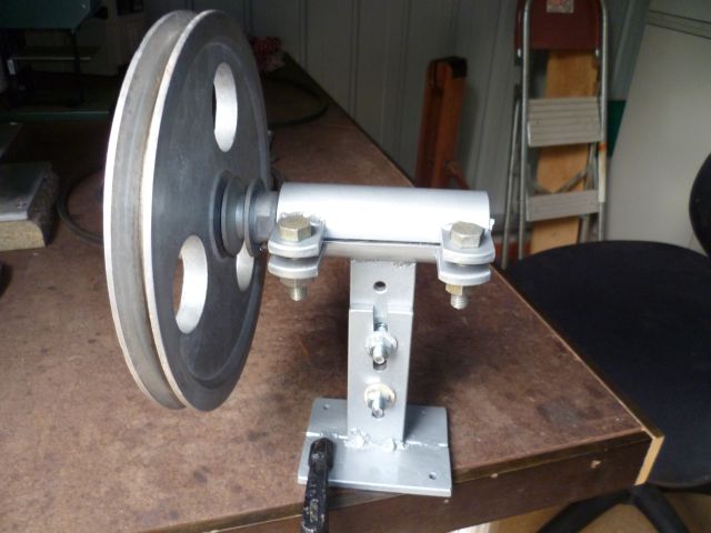

  5. I will have to disagree with you on this one, Sticks. My first machine had a clutch (of course) which scared the daylights out of me the first time I used it!! I made a larger handwheel pulley and made a speed reducer (modified a couple of times) in an attempt to control this beast, all to no avail. Yes, they slowed it down some, but I still had issues, and without fitting a gearbox(!) had reached the limit of a mechanical solution. After reading about servos here (and finally figuring out what they were talking about) I bought one from Aliexpress, Chinese company, of course but with a warehouse here in Australia. Cost was $250 Aus, about $220 US. Best thing I bought, in fact I bought two more! No problems so far, and the control it gives me is awesome. There is no way I would spend $1000 on a servo, not for my needs (and I'm pretty sure many will agree, it's a bit over-the-top for a hobbyist).

  14. And that, my friends, is part of the problem! When I get interested in something I have a tendency to collect "things". Space has also become something of an issue, so the little voice is saying to wait - until the right one comes along. While it would be nice to have, it's not going to be the giant leap forward that I need/want.
