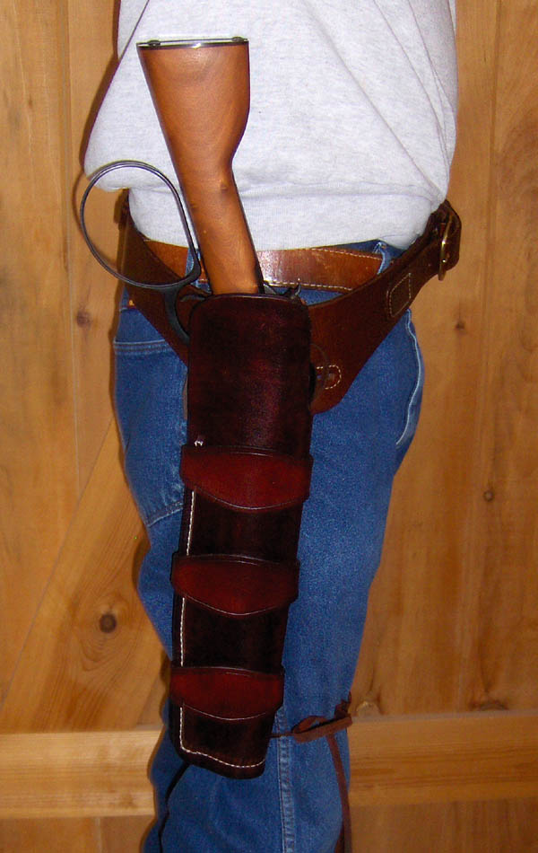

And here are the ones I was trying to design the other day when I saw your post, . . . May God bless, Dwight
