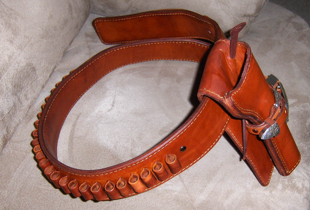

To use the vacuum bag, . . . cut out your pattern (vac 6 picture) Prepare your firearm properly, in this case I had to make sure the sight channel would be made, by taping a dowel onto the top of the revolver. Don't forget to do this !!! WET the leather, . . . like REALLY wet, . . . almost sopping, sloppy wet, . . . wrap it around the firearm in it's general final position. You do not have to be perfect with this part, . . . but the better you are, . . . the better the end product. I'll usually lay it down and thumb in a couple places to help keep it from moving. -
There have been a few threads in the past little while about molding and forming. I started out doing the thumbs, fingers, dowels, etc, . . . made me tired. Went to a press, . . . worked great, . . . got scared that some day I would crunch someone's plastic fantastic shooter upper. Researched vacuum forming, . . . with a little help from a carpenter / cabinet / window / door maker buddy. This is the system I now use, . . . just thought I would share. It starts out with the 3 basic tools needed: a vacuum pump, . . . a bag, . . . and a way to seal the bag. The pump came from Harbor Freight, . . . $100 more or less, . . . it is the cheaper of the two they sell. The bag is a piece of clear vinyl from JoAnns, . . . doubled over, . . . 2 inches of the edges stuck together with Weldwood. The seal is two pieces of PVC plastic, . . . 1/2 inch and 3/4 inch, . . . cut the groove in the 3/4 with a table saw and a lot of care.
