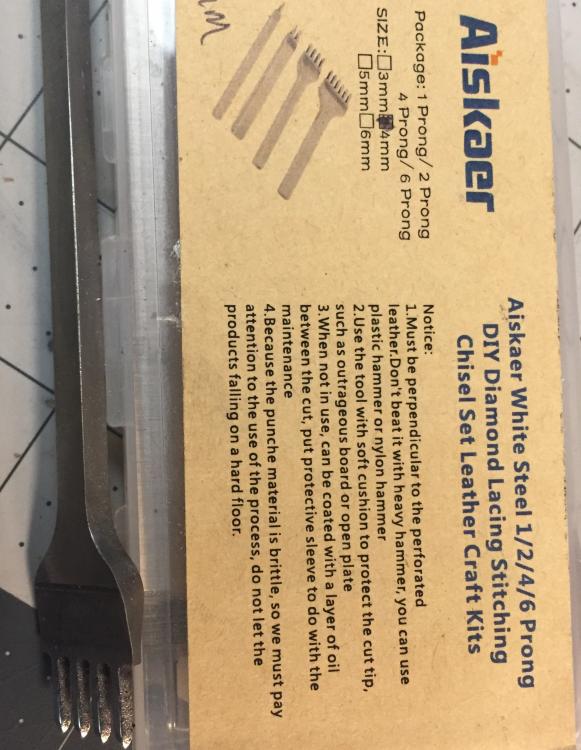

I can't speak to the awl much. I don't use mine unless I need to make a hole bigger for what ever reason. However you mentioned the chisels and I have a little experience with those. I bought these on amazon for about $13 for the set. For 1mm thread I use the 5mm version. Pictured is the 4mm. They seam to be pretty good quality. I have been pretty happy with them. And I pound all the way through at least 10oz maybe more, no awl needed. I put a piece of scrap leather and a soft 1x4 under my project. You don't want to drive them into you work bench or your stone. You have to be careful with the cheap Chinese thread on eBay. I bought some to try, what I got in I was not really happy with. You can make the color fade with just a little pressure of your finger. There are sellers on eBay and rmleather supply and also egyptianleather on Etsy sell small quantities of tiger thread. It costs more per foot but is less money up front. I am also thinking about doing something similar with some thread that is a very close kin to tiger thread called serabraid. Hope that helps at least a little, Brian -
