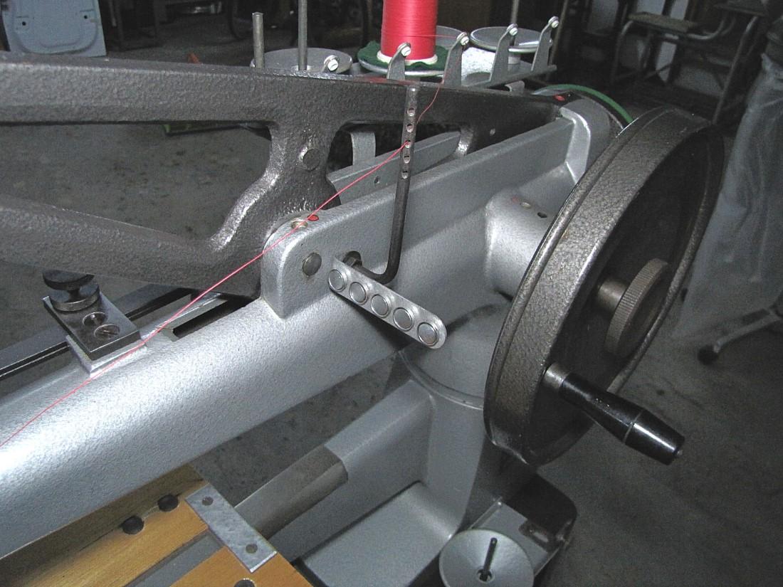

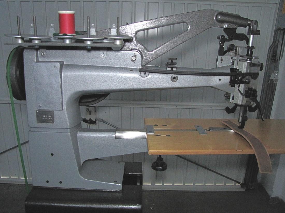

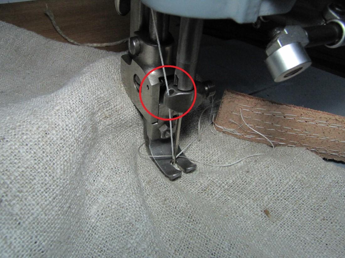

what I have noticed so far is: The needle plate / throat plate seems (!) to be modified and an the needle plate is missing material (or a deflector cover) left side of the roller foot / feed dog. Maybe this is something custom made but I can`t tell from the pictures. Not sure why this is but it is / looks unusual IMO. BTW - the original 105-27 came set up as jump foot machine and not with roller foot. So seems your machine has been modified quite a bit. But this could be custom made and I don´t want to judge this but it is not how the machine left the factory. In your video it seems (!) that 2 thread guides are missing, one on the needle holder (seems to be ground off somehow) and one on the face plate. Therefore the thread is "bouncing" around. This may affect the loop forming and that could cause thread breaking. EDIT I: Some one has modified the shuttle race as it seems. Your is held by 2 screws (maybe they are too tight???) but originally it has a U shaped sheet metal leaf spring that is holding the shuttle race in place. But again - could be a modification a customer asked for. Hard to tell w/o knowing the history of the machine. EDIT II: some pics of how the thread guides look on an Adler 104
Thank you, I'll give it a try this weekend. And make a video and look at the hook to needle timing! If the hook to needle timing was wrong, how would I go about adjusting it? It is indeed a beautiful old machine, very happy with it. I wasn't prepared for its weight when I went to pick it up from the seller 😅, my arms hurt for days 😆
