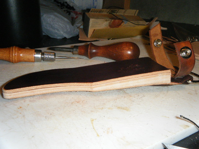

  8. It made sense to me. I only needed the wedge to make up the difference between where the very large guard rests on the back of the sheath and the top of the blade. If you can picture the knife laying on a table with the tip touching the table and the guard also and see that triangle. The blade as I have done runs exactly along the welt and the wedges just house open space. If I wedged front and back with the welt straight down the middle the welt would not have been on the same angle as the blade. This may be all wrong, it was a learning experience and the first time doing it. Kevin

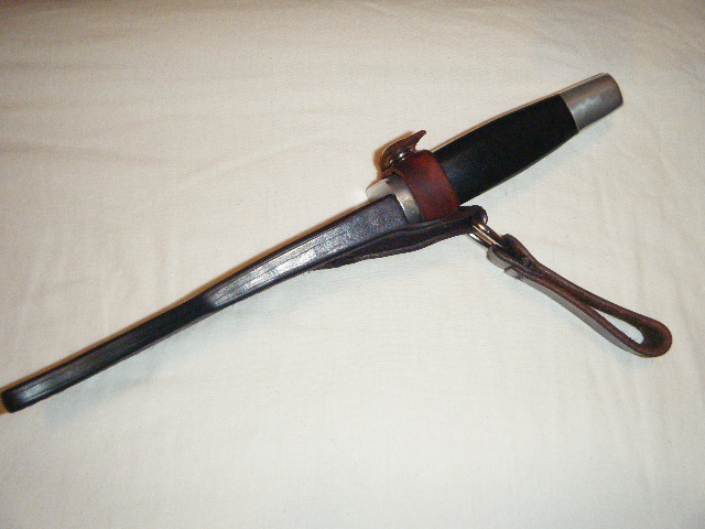

  9. It is made for a right handed person, but, they wish to wear it on their left side. I didn't argue, (except about the rivets mentioned above) did as they requested. Thanks for the comments guys. Cheers, Kevin

  14. Just looked at this again with the new comments, i still love it, but I noticed the lacing looks backwards to me. I could be wrong, but it looks like you laced it with the guts facing you puting the nicer side of the lacing inside. Just a thought. Kevin

  16. Here is what I came up with. This is what it will be for this one as I need to get it shipped. I really am interested in criticism because I want to get better at these things as I really enjoy making knife sheaths and outdoor gear. It's not stitched yet, I talked the customer out of any rivets, and they only wanted a single stamp so it isn't tooled. Thanks for looking/criticizing/helping! *edit - the line under the top most piece of leather is dye from dying the underside before assembly it is not a gap. Also I'll be sanding it a bit more. Kevin

  21. So, I want to put a full thickness welt the whole way around, I believe I'll need to add 2 more thicknesses in wedges/shims I think I've seen them mostly added to the backside of the welt, is this standard? Also is there a certain angle I should try to attain when skiving the wedges? I appreciate any help, thank you. Kevin

  24. I'm making a sheath for someone and the request is far from the original. I've never had to make a sheath before that required multiple pieces to accommodate the very large guard on THIS knife. Laying down, from the bottom of the guard to the topside of the blade is just shy of 1/2". I'm looking for some tips/advice when adding a welt with "wedges" (feel free to correct my terminology) Thanks, Kevin
